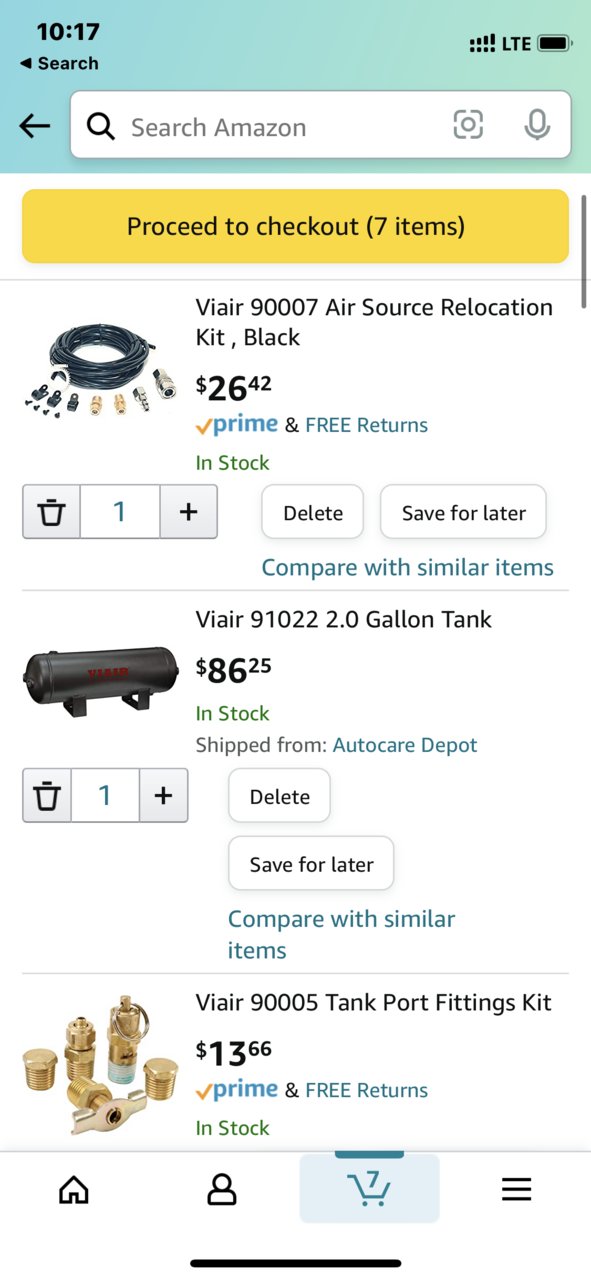

    Is this everything I need to connect my compressor to the tank? Do I need a leader hose? If so which one? How do I connect that long air hose from my compressor to my tank? Thanks a lot.

    That should definitely get you started. :thumbsup:

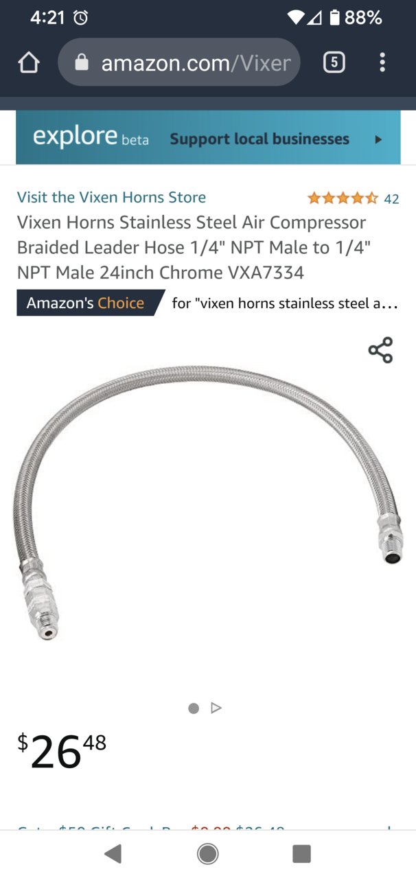

    It might work without the stainless header, but the output gets pretty hot after running a while, possibly in the time it takes to fill your tank. The plastic in both the fitting and the tube might have issues.
    Might want to add the braided stainless header line to help dissipate the bulk of the heat generated near the output of the compressor.

    Would this be fine?

    One way to find out, but I think it would.

    That braided hose, what is the PSI rating?

    Looks like 175psi. More than enough.

    yup 175.

    I would suggest this leader instead, as it has a check valve already.

    A bit longer at 24" for better heat dissipation and also rated much higher at 250psi.
