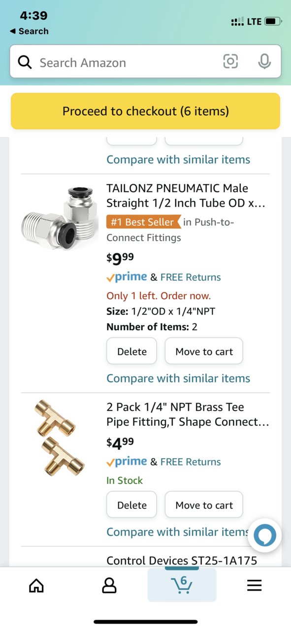

    But wouldnt the air chuck benefit more if connected to the tank instead? The way you described it made it sound like it would just run from the compressor.
    and do you mean these?
    it shows 1/2 but it should be 1/4 od and npt I think.

    Personally, I have braided lines throughout my entire setup. I don't want to chance melting something along the way.
    Compressor is mounted in the engine bay, tank is behind driver's side taillights, and QD is by my license plate. The braided lines help cool the hot air down. By the time it's leaving through the QD fitting, it's barely warm (for the length of time I have ran it at least).
    My parts list:
    3 meter braided line (to run from compressor to tank, just long enough to reach) - ARB0740206 (2x)
    Adapter (to connect hoses together, comes with 2) - ARB0740102 (1x)
    1.5 meter braided line (to run from tank to QD) - ARB0740204 (1x)
    QD - ARB0740111 (1x)
    ARB Tank (kind of small but it works well, it's aluminum, and it comes with two 45° fittings) - ARB171601
    ¼ NPT "T" (any that can support the PSI)
    Hotblasters electronic drain kit (single tank - to drain condensation and wired up to my Switch Pro as a momentary switch)
    While I don't expect you to copy my setup at all, the lengths and parts should help you decide on what will work for your setup.

    The check valve just needs to be somewhere between the compressor and the tank. It can be mounted at tank for sure.
    And yes, those parts are correct.
