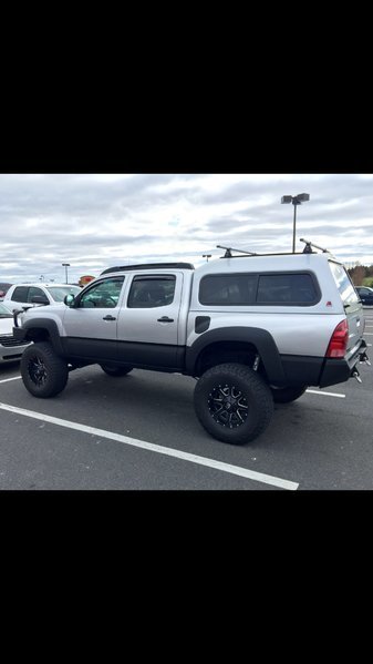

    Plenty of great products so far !
    image.jpg My cap guy said a gasket was under the cap edge from the factory. No silicon and no leaking for 7 months and 40,000
    0210[OP] likes this.
