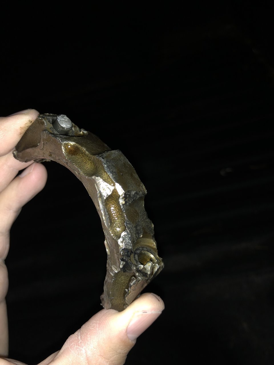

    He's 19, pretty responsible. It happened yesterday evening reportedly while just driving down the road. He said he was driving along, heard a loud pop, and the engine died. He said it was dripping a liquid.
    When I arrived I briefly looked at it, could not tell where the oil was coming from, so I asked "where did this happen? How far back on the road?". "was it where that piece of metal is laying in the street?"
    Here's what appears to be the bottom end of a rod.

    Looks like the rod cap. Never had one of those break

    These motors DO NOT just throw a rod unless there was something else that failed.
    Maybe the rev limiter was not working, oil pump or something else.
    You can actually rev the heck out of these motors without any problems

    did your son notice the oil pressure indicator light before this happened?
    not sure if that would light up before this happened or not
    perhaps indicator light was not working?

    I have a feeling it might've been previously repair that wasn't done properly

    I've seen a good bit of broken stuff, but can't recall seeing a cap laying in the road like that. Much more likely to be a rod out the side of the block.
    So is there a hole in the oil pan that was the exit path for this?
    When you pull the motor take some more pics for us. Then flip it over, pull the pan and show us how many pieces the crank is in.
    I'd go the low mile used engine route.
