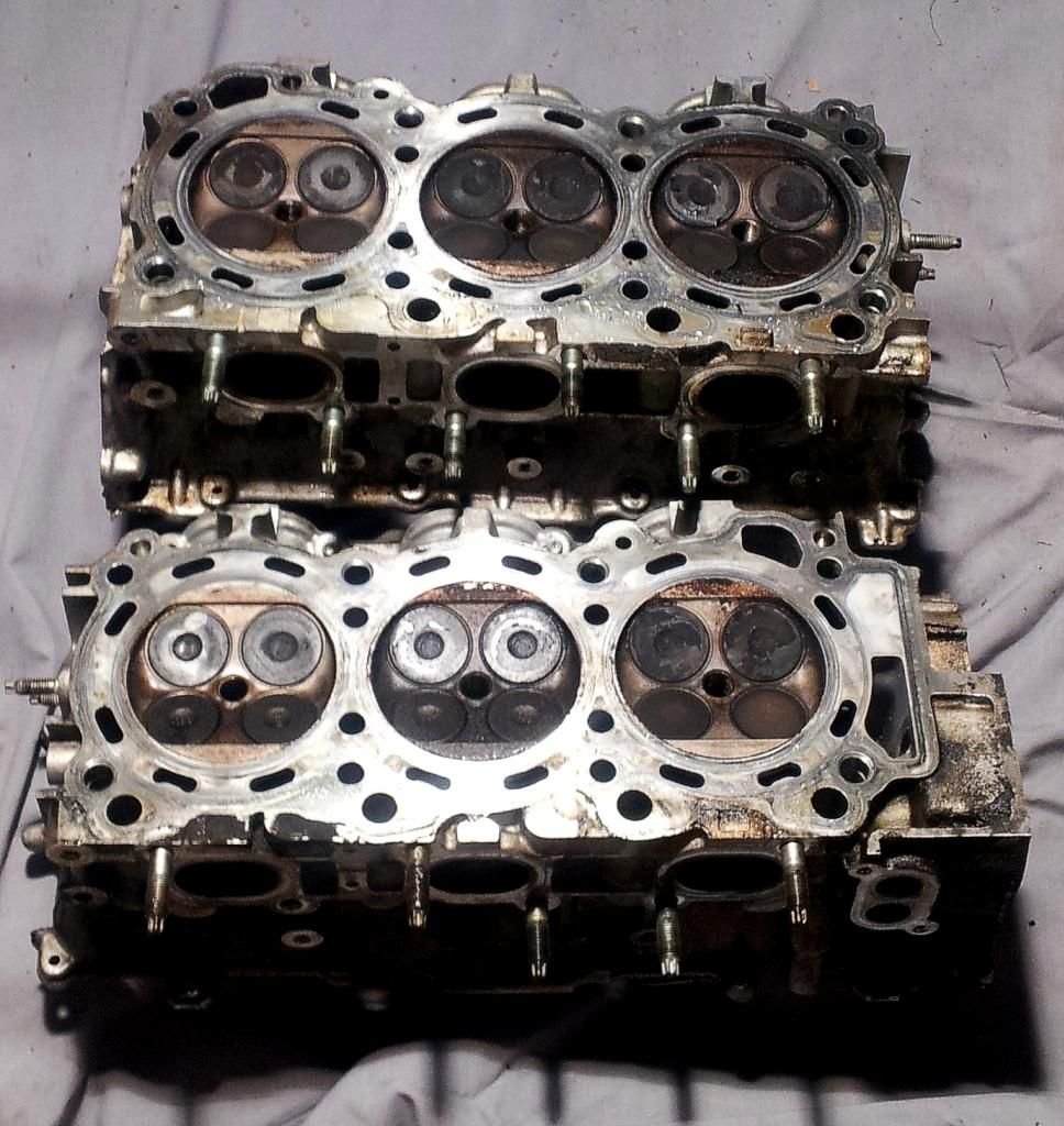

    These early 3.4l 6 cyl engines had a reputation of head gasket problems/ issues . My bet is the rod failed due to a Hydrolocked cyl from ingesting coolant . As we all know a piston can't compress liquid and the rod failed " bent" causing failure of the rod cap
    I bet when the " OP" pulls the cyl heads off the combustion chambers and valves will have an orange color on them . This is tell tale sign of coolant leak

    TRD supercharger , Doug Thorley header , K&N CAI 265/75-16 Toyo open country mud terrain , 15x8 Method Racing wheels , Rancho 3" lift , 4.88 gears , Detroit Locker
    Not when you hydrolock a cyl !!!!
