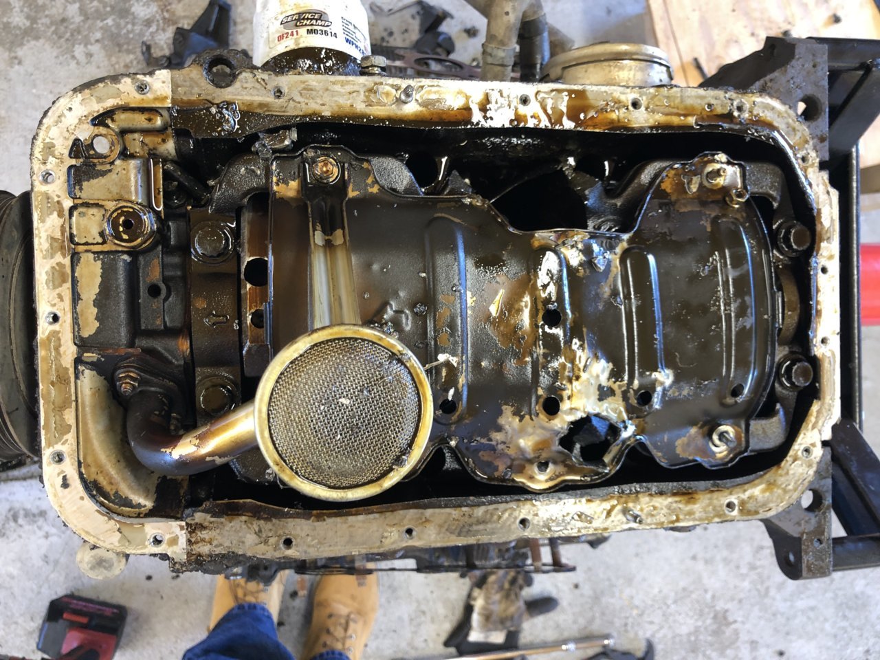

    Holly cow!!
    Something major gave way. Oil pump look bad?

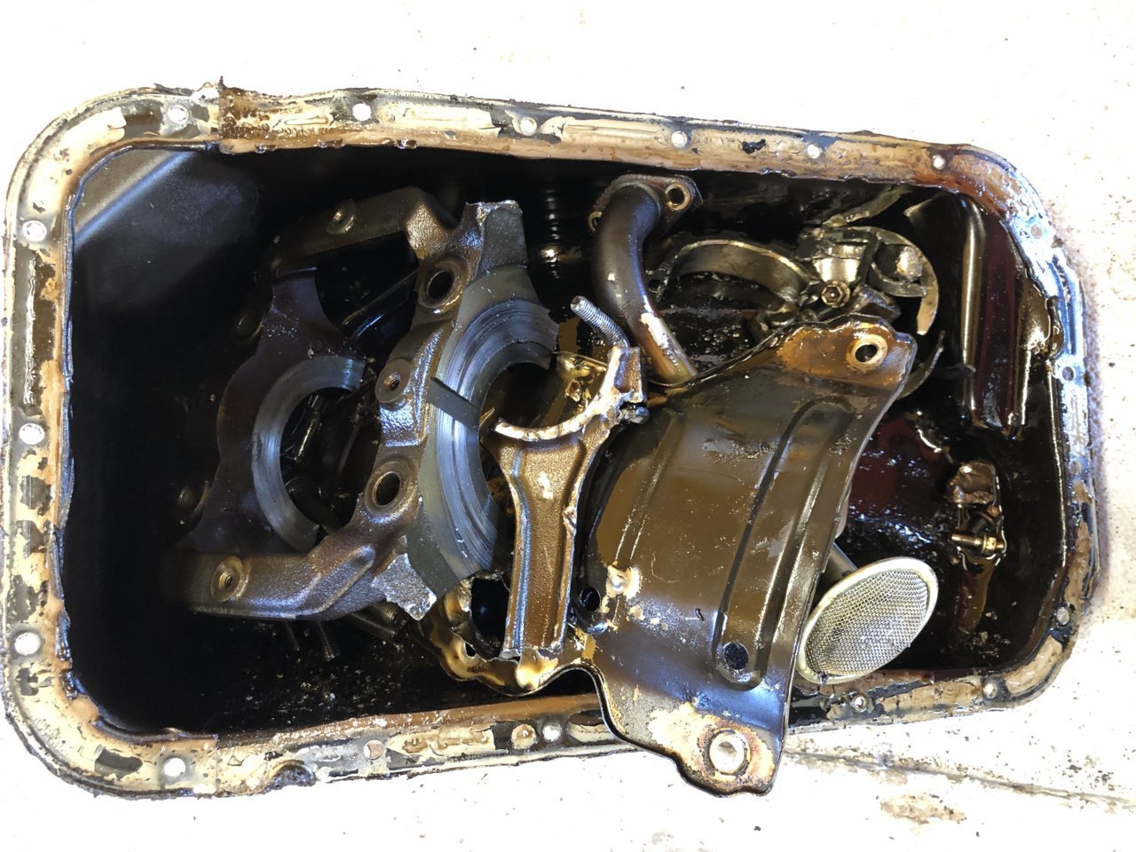

    yea, she had a rough day. the main bearing cap girdle is toast too

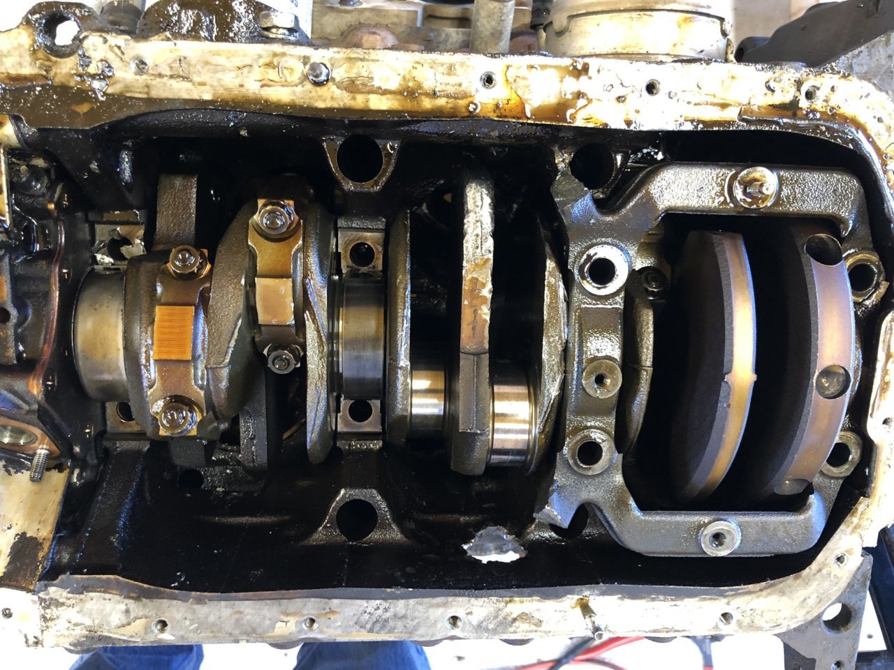

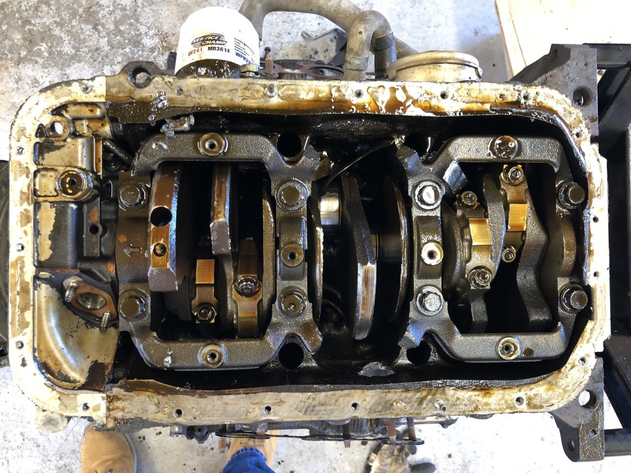

    Can you layout the rod pieces and caps for a clean photo?

    That looks just like my friends race motor after700hp hit of nitrous !!!
    Did the rods that let go show any signs of excessive heat ( discoloration) just above the crank journal ??? . That would be a dead giveaway for loss of oil pressure to those bearings

    I'll add if the OP can show close up of the rods just above the crank journal for heat discoloration
