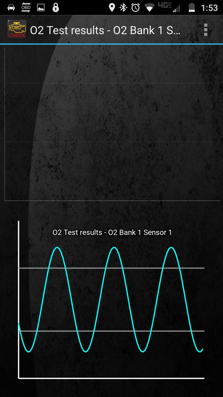

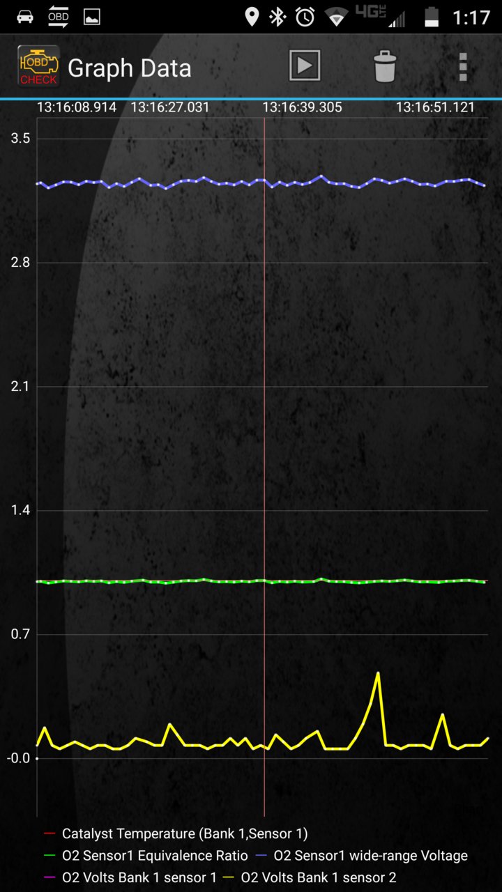

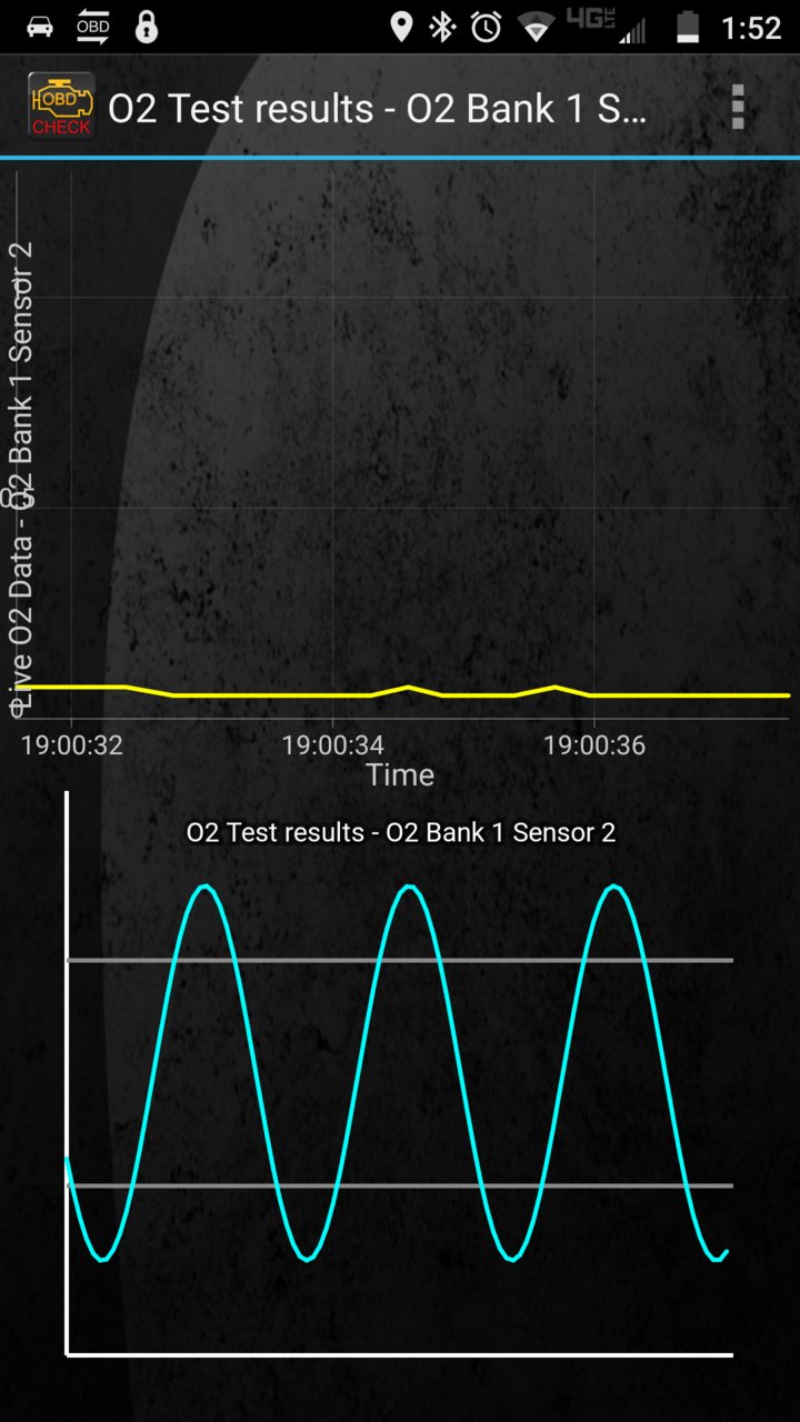

    Ok I am no expert on vehicles. I just ran the Torque Pro app and tested the O2 sensors. Here is the data it shows. Notice no data for the Bank 1 sensor 1. I am either gonna be stupid in saying this or not. lol Does the no data for the Bank 1 Sensor 1 upstream sensor mean its bad or bad wiring and that is the reason for the P0420 code? Here is the data:
    Screenshot_20180925-131704.jpg Screenshot_20180925-135321.jpg Screenshot_20180925-135300.jpg

    Before concluding o2 sensor is or cat is bad, have you tried cleaning your MAF sensor and throttle body, or replacing sparkplugs (if it's been a long time since they were last replaced)? Common causes of p0420, with exhaust leaks. Do that, clear the code and see if it comes back
    And to answer your question, how long did you let the truck run? To diagnose properly, you need to have the exhaust reach it's normal operating temperature (a few hundred degrees). Sometimes you won't see output data until the sensor or cats have reached operating temperature.

    I just drove for 15 minutes and then plugged in the BAFX Bluetooth diagnosis plug and it still is not giving me any data for the O2 bank 1 sensor 1. It shows bank 1 sensor 2 data. Can I unplug the bank 1 sensor 1 and check voltage with a digital meter and determine if it's bad? Thanks

    I see now... if you have a 2000 and later truck, you have an air/fuel sensor (wide-range o2 sensor) as the upstream sensor instead of a regular oxygen sensor. I believe it does show up as the blueish line (o2 sensor 1 wide range voltage).
    Usually, upstream sensor readings will fluctuate while downstream sensor will be fairly steady.
    yes, you can test oxygen sensors with a voltmeter. The two black wires are the heater element, blue wire is signal + and white is -
    https://www.youtube.com/watch?v=DvKZ2GDYEz4
    though, if sensor was bad, you would normally get a specific error code for it
