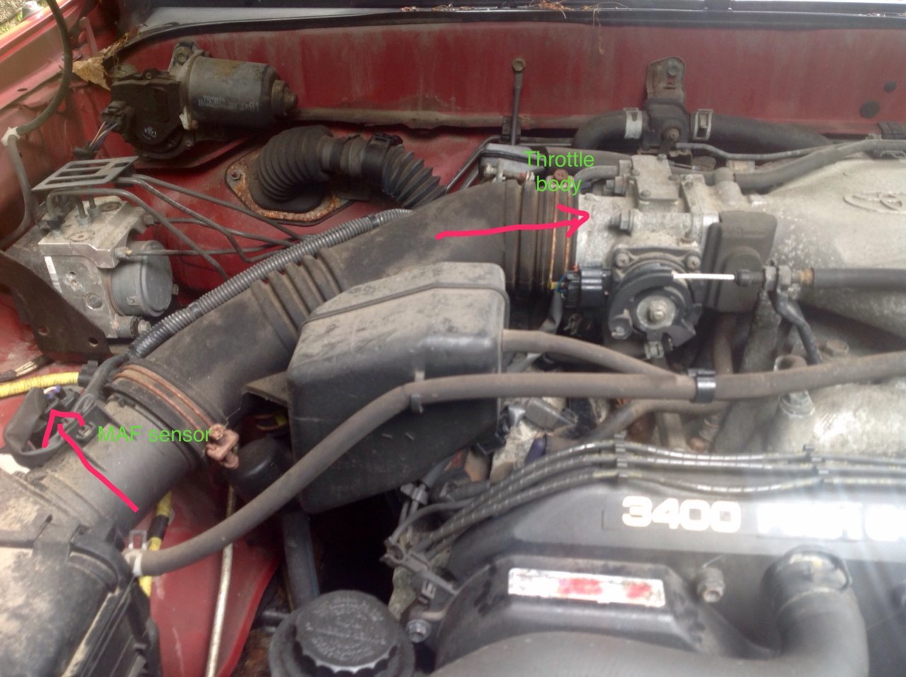

    IMG_2665.jpg Also here is a picture of where my Throttle body and where my MAF sensor is. It's pretty simple to take off the MAF to clean it but what is the easiest way to remove that intake hose off to get to the throttle and spray it. I would rather not take off more than I have to just to clean it. Thanks.

    Well, it's not that hard to remove the intake hose. You just unclip the airfilter cover then undo the collar/clamp thingy that is holding it to the throttle body. It will slide right off.
    The with the air filter cover out, it will give you access to the MAF sensor (good view of it when you turn it around)

    Well I just cleaned the MAF sensor and Throttle body. I disconnected the battery before doing so. Started up the truck after I was done. White smoke came out for a couple minutes until it dissipated. I read where that is normal. The CEL turned off from the battery being unplugged. Now I just sit and pray it doesn't come back on. I have my doubts this is what caused the CEL. Lol.
