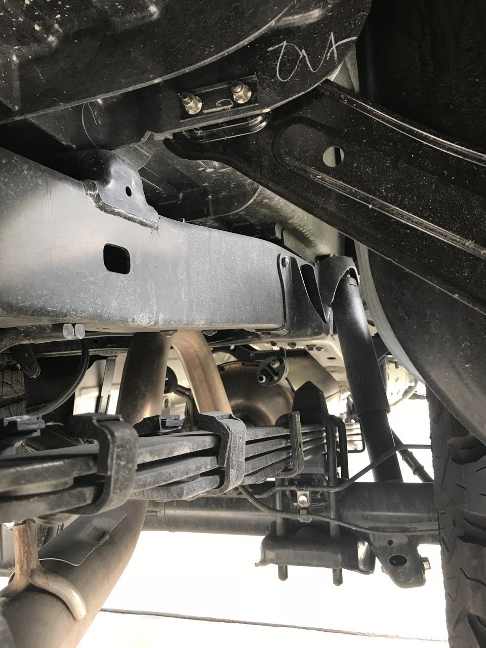

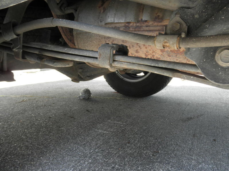

    There’s a smaller spring underneath the larger ones you’re seeing. It’s an overload leaf spring. Here’s a pic of the old packs vs the new.

    All recall springs are 3+1 with 4 clips.
    For some reason the US ran 2+1 a lot longer than Canada. We had very few of the 2+1's here.

    Yep those are what I have. I am surprised I can haul any weight with those bra straps for a suspension.
