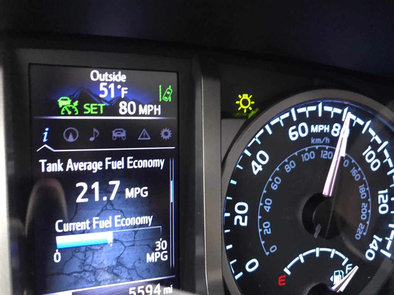

    My '18 Limited has about 5k miles on it. It had the similar characteristics that so many on here have noticed. 1) When cruising at slower mph(around 20-40) no acceleration upon gradually pushing on the accelerator then all the sudden downshifting hard a couple gears then really taking off. 2) Constantly shifting on the interstate when cruising at highway speeds, especially when bucking even the slightest headwind or going up a slight grade like an overpass or the like. 3) Hard sift between like 1st and 2nd when taking off from a stop. 4) always shifting to that 6th gear as fast as it can...even like at 30mph on a city street it would run at like 900rpm. I've often felt this truck has a powerband like a 2-stroke motocross bike....nothing at all and then all the power at once when it 'gets up on the pipe'. Anybody ever made that comparison before?
    Anyway...NOW the results after the TSB. My ride to and from the dealer is about 30 miles each way, mixed with about 10 miles of city/highway and 20 miles of interstate driving. I made a mental note of all the things it was doing on the way. And that includes all the things listed above. On the way home...ALL of these issues seemed to be fixed. AND on the way there my trip mpg was 16.2. On the way home it was 18.9. It seems to shift much more uniformly when taking off from a dead stop. And the best thing was it didn't seem to wanna see how fast it could get to that 6th gear like always before.
    I am beyond thrilled with the outcome!

    2nd full day after getting the TSB done. I had about an hour trip on I-57 in Southern Illinois. Can't believe the difference in gas mileage and the way the truck drives! This was an hour in to my trip, (adaptive)cruise set at 80, and traffic was heavy with it being close to Christmas so it was constantly slowing down and the getting back up to speed, hilly with several overpasses, etc... Before the TSB the best this would do was about 17.5. Again, if you haven't gotten this done yet, I HIGHLY recommend!

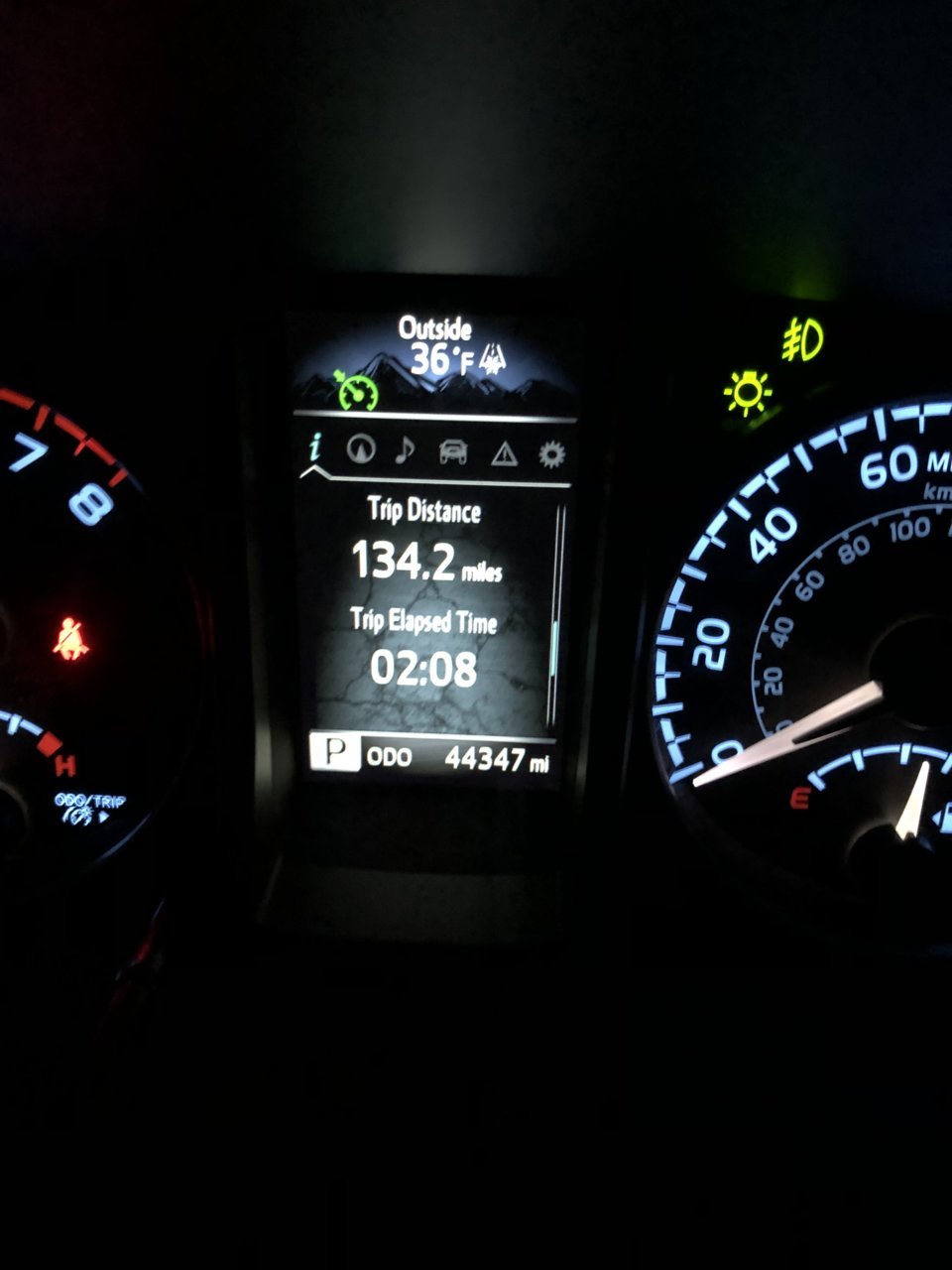

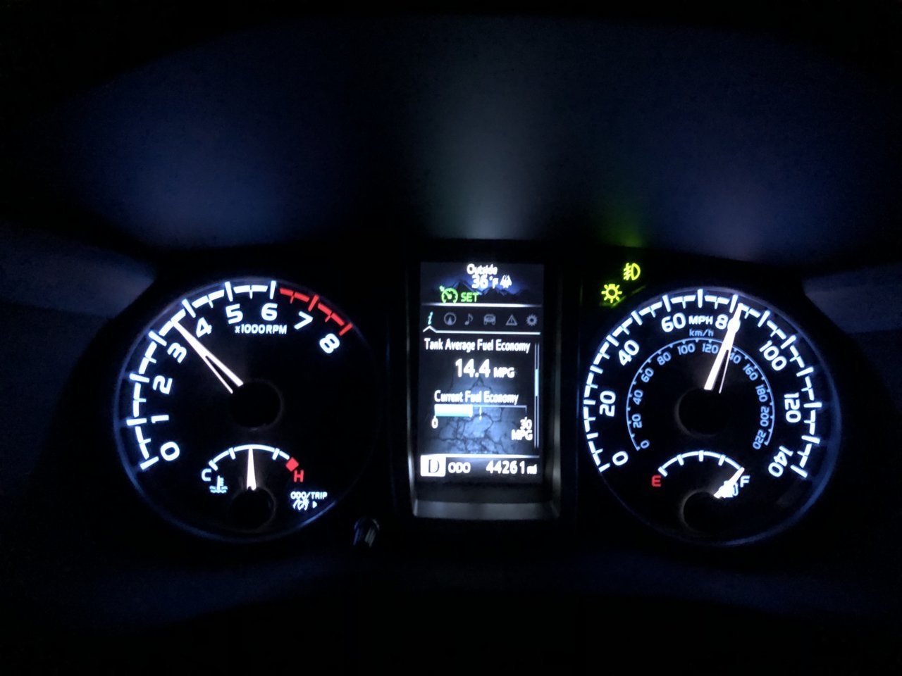

    You guys all need OVTune. I averaged 19.2mpg today over 140 miles. My truck has 32” tires and weighs 6000lbs
    Donjuan likes this.

    Lift, Method 305 Wheels, Bed Lights, Interior LED conversion, Derpy Badge Blackout
    I looked into OVTune. It looks awesome but I can’t afford it right now. I also don’t feel I should have to pay for that to get average fuel economy.
