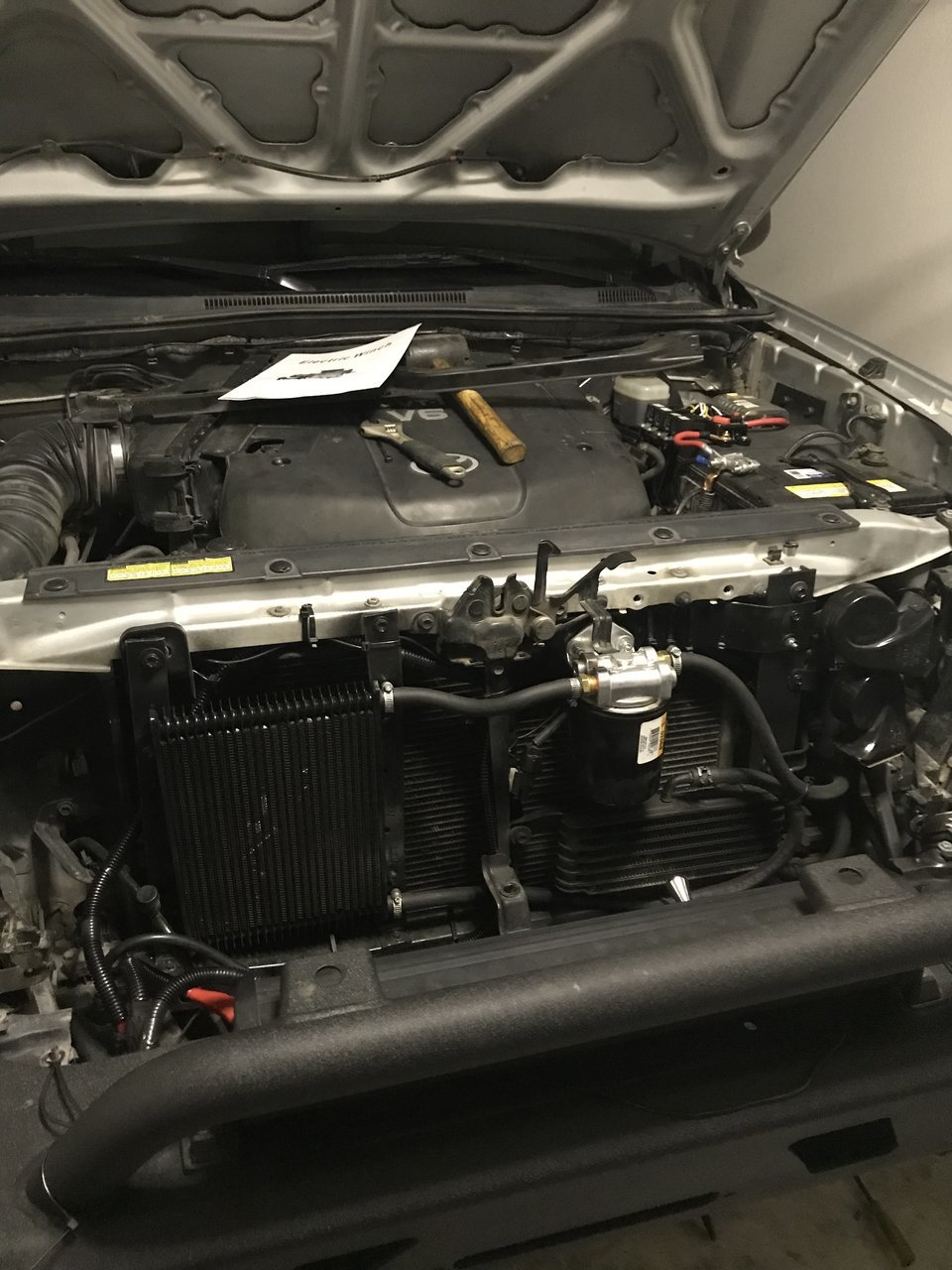

    I have a uktragauage so that was simple.
    I actually had a problem after doing the flush. I didn’t clean the pan at first and after the flush the truck pretty much wouldn’t run. Idle extremely low and the truck would roll backwards and die on any hill. Something got clogged in the tranny But luckily it came out. Cleaned the pan and new filter after that.
    Added a external filter too. Did my buddies a few days later and his went smooth
