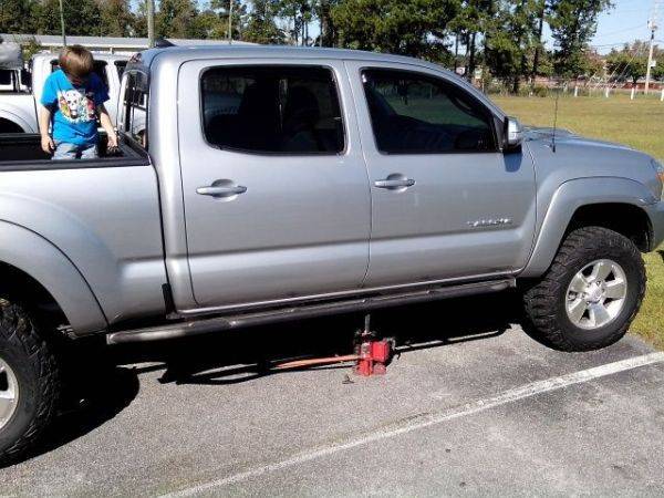

    I have put 275/65r18 bfg at ko's on a factory limited sport and they did not rub at all- if anything maybe mud flap or the little removable plastic flap in the front wheel well but I don't think it hardly even hit that.. If I had factory 18s and no lift then 275 65 18 is what I would go with or honestly I would push it (maybe rub uca) and go with 285/65r18 but that's just me..

    Bigger tires don't rub as much on the front bumper of the 2012's and up unlike the 05-11 cause they hang down lower

    Normal driving conditions 275/65 r18 will work and not rip off your fender flares or anything like that and it will fill the fenders up good... but like I said depending on truck it might very very very slightly touch mudflaps or the front plastic flap in the front and not much more than that.... at least the one we put 275/65r18s didn't (and we of course checked to make sure)
