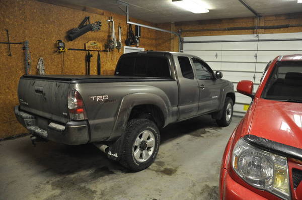

    Here is what the highside looks like...Im assuming this is what its supposed to look like. Couldnt really get a pic of the other side but its a little over a half inch off from the floor to fender.

    So you have not installed the front lift yet, which includes the lean spacer? And it is leaning?

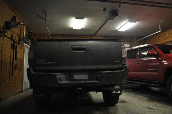

    and here is the back. [​IMG]
    this pic makes it look a little worse than it is. But there it is!

    Check out my Build to See!
    Yes...correct. It never leaned before when the rear was stock. Not sure why it would now..

    Yep, that's the Taco lean. I can notice it on my truck on occasion, but to most people they can't tell.
    BTW, two Tacoma's in one garage, nicely done sir, nicely done.

    IMO you probably just didn't notice it before. Double check your work so far, finish putting the lift on and see what happens.

    Umm... maybe the garage is crooked.

    Exactly. I noticed it on my stock truck as well, usually only with a full tank of fuel.
