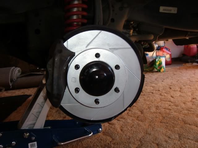

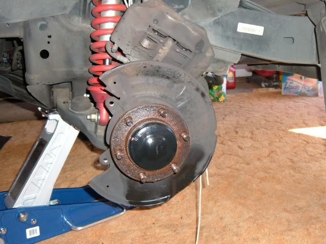

    Sorry but these are the only pictures I have. Nothing much to say about them yet. Still trying to break them in. The bite is better. Overall??? Not sure yet:
    The install was very easy coming from a guy who doesn't work on his own truck:
    -E-brake on.
    -Block the rear tires (I used two spare tires).
    -Loosen the lug nuts.
    -Jack up the front.
    -Remove the lug nuts and wheel.
    -Loosen two of the 17mm bolt holding the caliper.
    -Tie it up on the UCA. Don't let it hang.
    -Bang on the rotor with a rubber mallet until it knocks loose.
    -Remove old rotor.
    -Clean the hub and studs of rust to avoid pulsation in the future. Wire brush, drill with a wire brush attachement, WD-40.
    -Can paint your calipers now (I opted not too).
    -Spray new rotors with brake cleaner.
    -Install new Power Slot's. L = driver, R = passenger.
    -Repeat steps in reverse.
    -Test drive with light braking.
