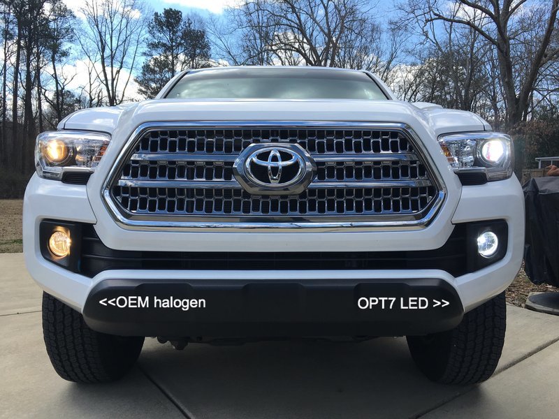

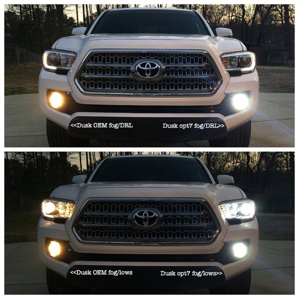

    Yesterday i removed the OPT7 750 lumen fog/drl bulbs that i had purchased from my fog light location on my truck and instead installed the OPT7 LED H11 headlight bulbs in their place. HUGE difference! Literally night and day. I am now totally satisfied with my decision to go LED on my Taco.
    I would caution anyone who is contemplating the LED conversion to be wary of the fog/drl 750 lumen bulbs. It is not worth the $68 dollar savings. They are WAY too dim (again, this is my opinion). From the factory, your rig comes with identical bulbs in the headlights and in the foglights and IMO that is how you should proceed with the LED's. H11 LED headlight units in both locations.

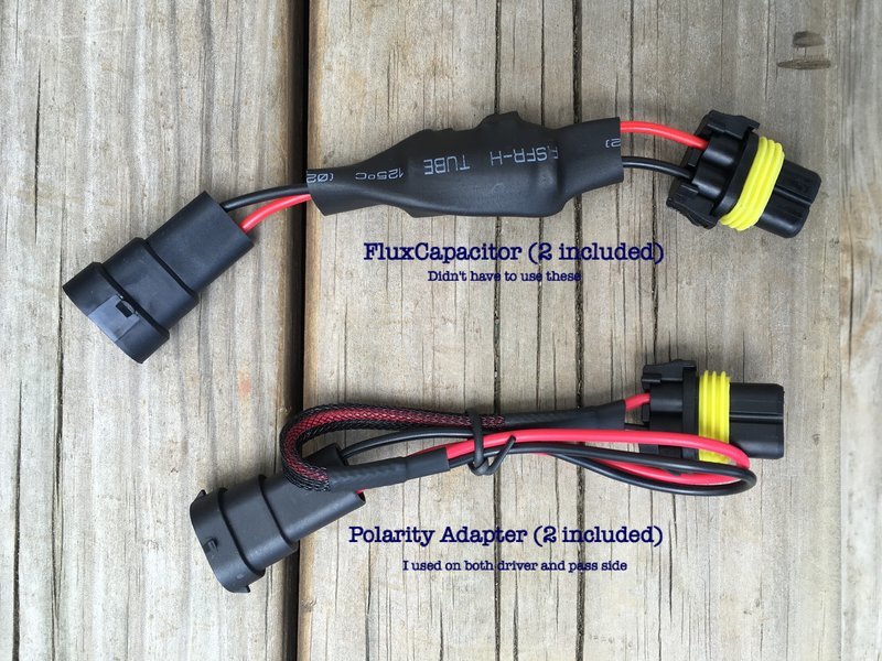

    Odd since mine didn't require it on either head light. Did the fuses pop right away or after awhile?
    Edit: After seeing the picture, I had to use the polarity reversing cable on both head lights. I didn't have to use their Flux capacitor piece on either however.

    When installing, what is the consensus with the polarity reversing cables and Flux cable for the low beam H11 and fog LED's?? I'm getting mixed messages: passenger only vs both vs none??

    I initially connected everything and it didn't work, once I removed the Flux capacitor on both sides it worked so I left it as is and didn't test any other combinations. The paper that came with the lights said you need to use them unless you have H4 or H7 bulbs.

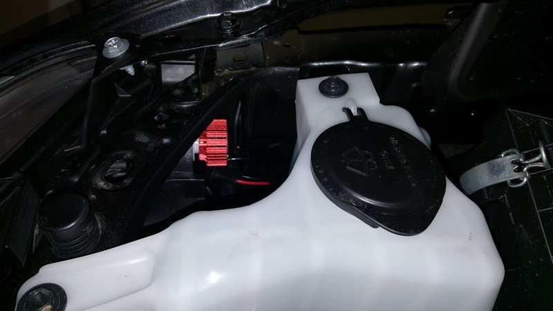

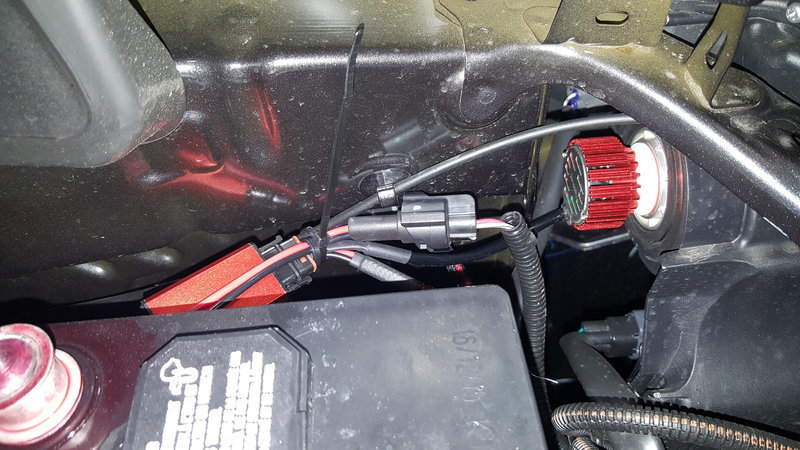

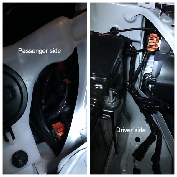

    Yes, use them unless H7 or H4, as the included info said.
    I plugged it all in and they both came on instantly, no problems.
    Driver side...
    Passenger side...

    Don't do this, you are going to blind oncoming traffic. Fog lights aren't meant to be a significant light source, therefore the lens isn't aimed or centered at all. By putting the high power LEDs in there, it will be as if you are driving around with your high beams on.

    It's not rocket science, the fog light lens has no focusing or aiming value at all. So what your doing is taking a high power LED and spreading the light everywhere. Your only gain from this is GREAT Illumination of the road for about 6 feet, otherwise your just being a nuisance to opposing traffic.
