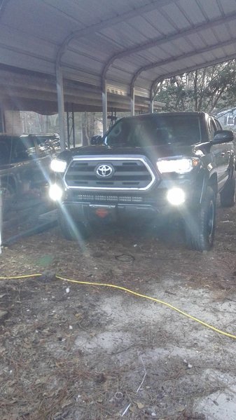

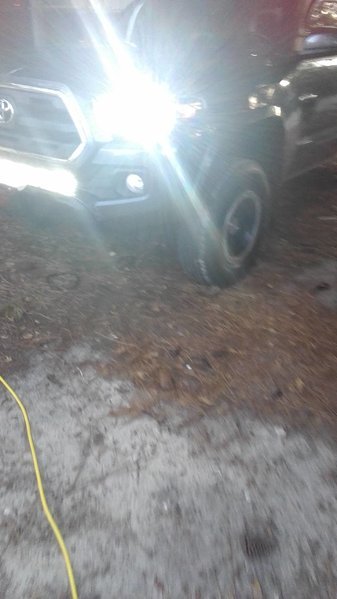

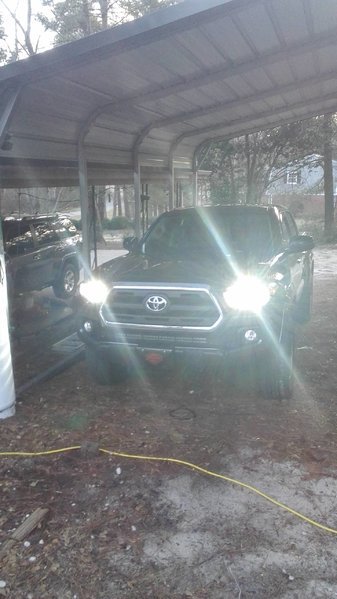

    IMG_20160306_180451_1.jpg IMG_20160306_180437.jpg IMG_20160306_180451_1.jpg IMG_20160306_180437.jpg IMG_20160306_180519_1.jpg

    These opt7 LEDs are amazing I put them in low beam projectors high beam and fogs I drive 145 miles in the dark both back and forth to work on mostly two lane roads and the light output is wicked bright the projectors have a clean cupoff just like advertising stated by opt7 the fogs put a lot of light down low where fogs lights should the high beams are the best and shine a lot more not further but cleaner light

    Just posted some I like these alot

    What type of Led lights are they?

    Nice pad, you live on the main road? I see you got lots of upgrades!

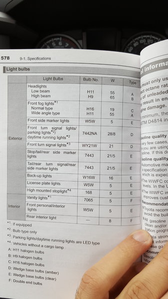

    All are NOT h11!!!!!
    High is h9

    same base but different wattages etc, some HID kits don't recommend full wattage in toyota fogs cause it can melt, etc, still, they aren't 'h11' all around
