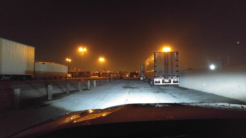

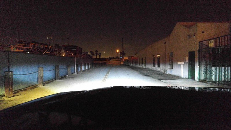

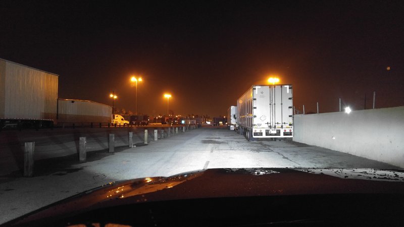

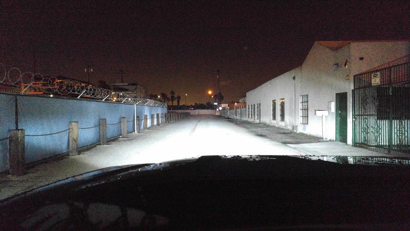

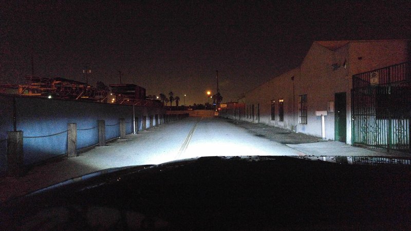

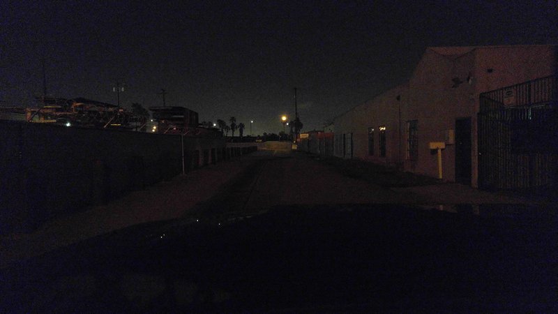

    I feel the upgrade is worthwhile, I couldn't see very well with the stock lights. I felt both the distance, output and light color left a lot to be desired. HIDs would be a bit cheaper and possibly be a bit more light, but they have a much shorter life. HIDs are good for about 2k hours, then you have to replace the bulb and usually the ballast goes with it. If this last the 25k, you'll be ahead in cost after 4k hours.
    So the first 3 photos here, I left my cell phone in auto and did not adjust any settings. I had them off, lows, then high beams:
    20160315_055816.jpg 20160315_055820.jpg 20160315_055831.jpg 20160315_055826.jpg
    The last 4 I locked the ISO in so it wouldnt dim down the photos when it detected more light. Lights off, lows, lows and fogs, high beams.

    Yellow fogs right?

    Yeah, I still have the stock fogs in. I was concerned that the LEDs would be too white and not cut through the fog or dust. Once I get to see how well the stock ones do in fog I'll make a decision if upgrading is worthwhile.

    Thanks for the great comparison. Maybe go with a 3k HID for the fogs. I might go that route.
