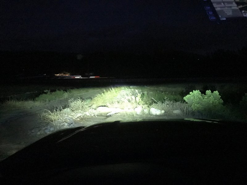

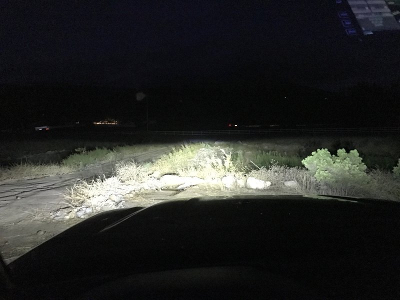

    For anyone interested here's a night pic of my Philips low beam HID kit 4300k and Philips 35w 6000k "xtreme vision ultinon" LED fog lights.
    First pic low beams only, second pic low beams + fogs

    I edited to explain, I still stuck with LEDs in the fog lights since fog lights are mostly to fill in the side areas (better illustration in pics I just uploaded).
    Low beams need to cut through more distance so I went HID. But even LED vs LED in the fogs theres a big quality difference in Philips vs OPT7, checkout the daytime pic to see what I mean by the blindingness of the OPT7s. I should swap the OPT7s back in to do a nighttime comparison but I promise you the Philips perform twice as good at night.
