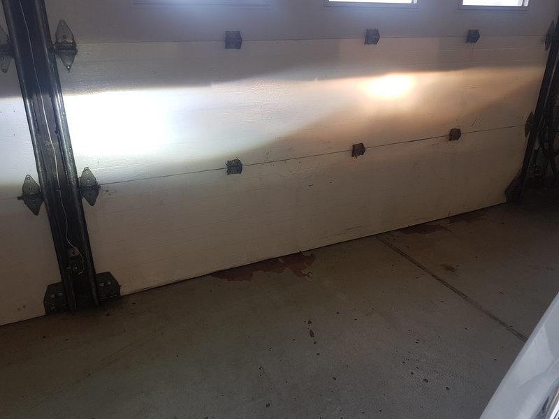

    Hylux 35W ballasts, CNLight 4300k lights, Diode Dynamics harness:

    Now that's good output! In my opinion LEDs are not quite there yet. For now HID's are far better

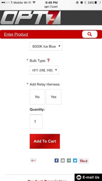

    I have The 2017,do you guys think i need the relay harness? For the fog lamps and headlights?

    Do you have any pictures of the output? Absolutely no fitment issues?

    What relay harness?

    If you are buying the LED headlights. They are plug and play. Just by the set and it has everything you need.

    i will try and get some pics soon.
    no fitment issue. that only thing when installing you have to remove the one headlight bolt up top to pull the light forward like 1/8" to clear the heatsink past but once its past there is tons of room.
    been running them for a while and I will say they are an improvement over stock. I can see wider and the throw seems to be about the same but the LED ignite up anything reflector from a MUCH further distance then the halogen did. so street signs and road markers are much more visible from further away even past how far the lights seem to throw

    @jctacoma17 It's better to get a relay for your lows if you're doing HIDs. It hooks up and pulls the power directly from your battery to power the HIDs. I just put in 55w HIDs In my lows yesterday and I used a relay harness to protect my factory wiring. I also put the blitz bullet on my fogs but no harness.
