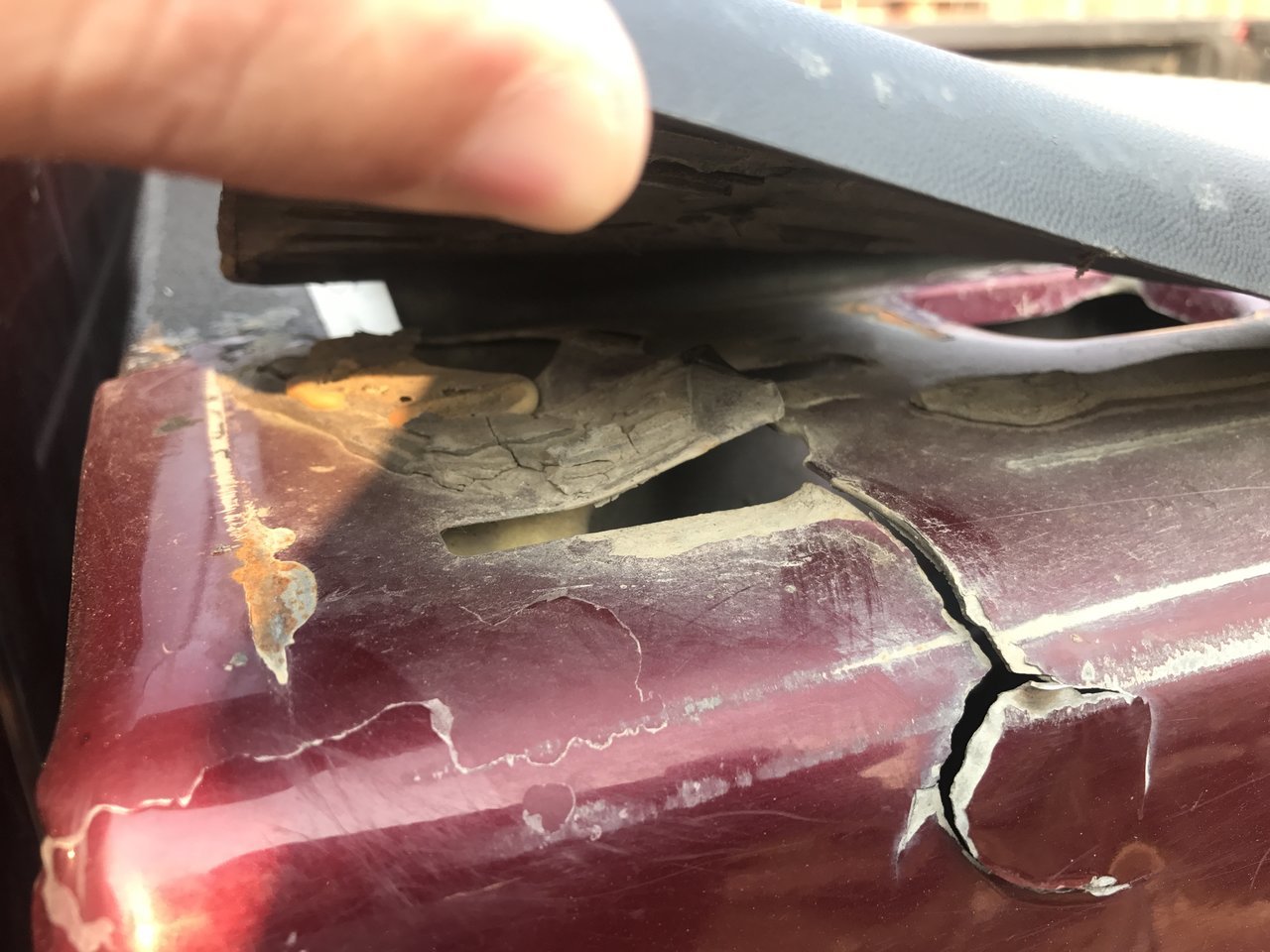

    Trust me the Super Duty, nor any other truck brand, is immune to bed problems with a canopy. Both upper corners are having issues, but this side is by far the worst. Although this is from constant off road use, some where around 7,000 to 8,000ish miles a year.. The canopy is also cracked, but down by the tailgate. Safe to say the canopy and truck have parted ways until I can fix and strengthen the bed.

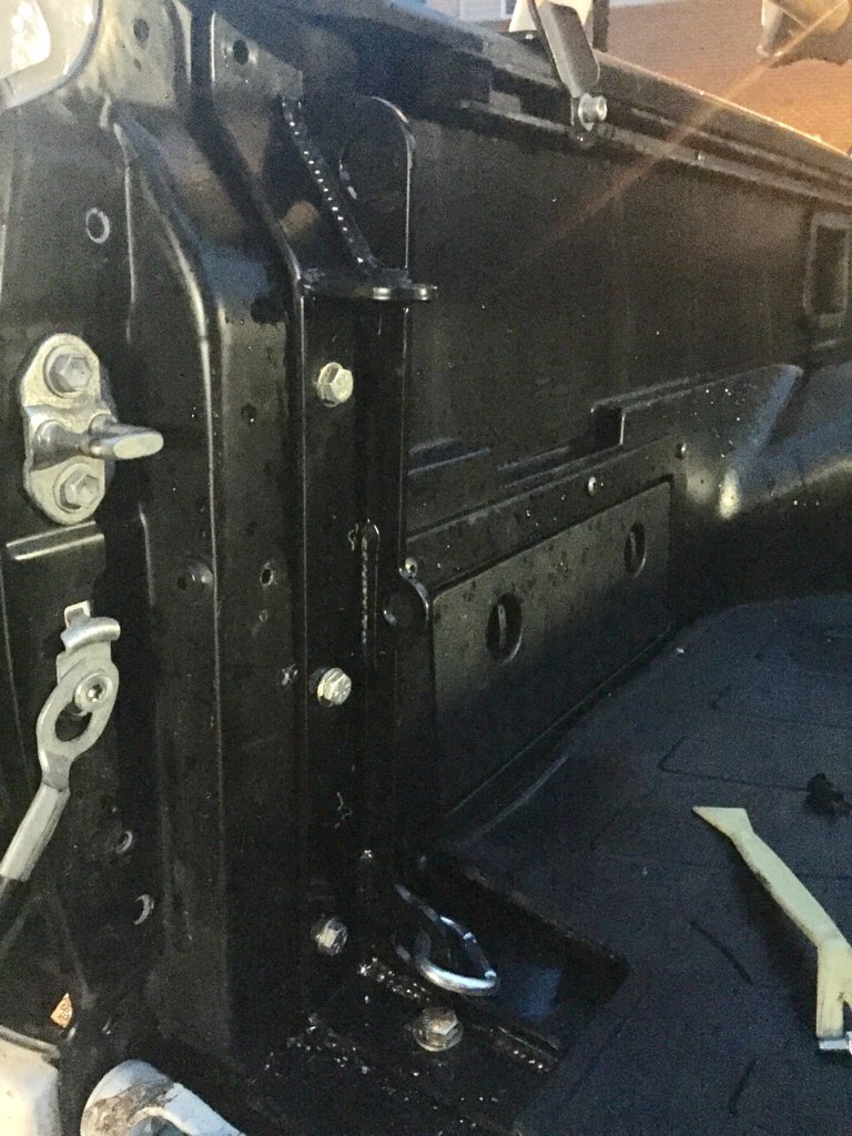

    I have these already. Sorry for the grainy photo. It fixed my bed gap, when the truck never had a cap on it!
