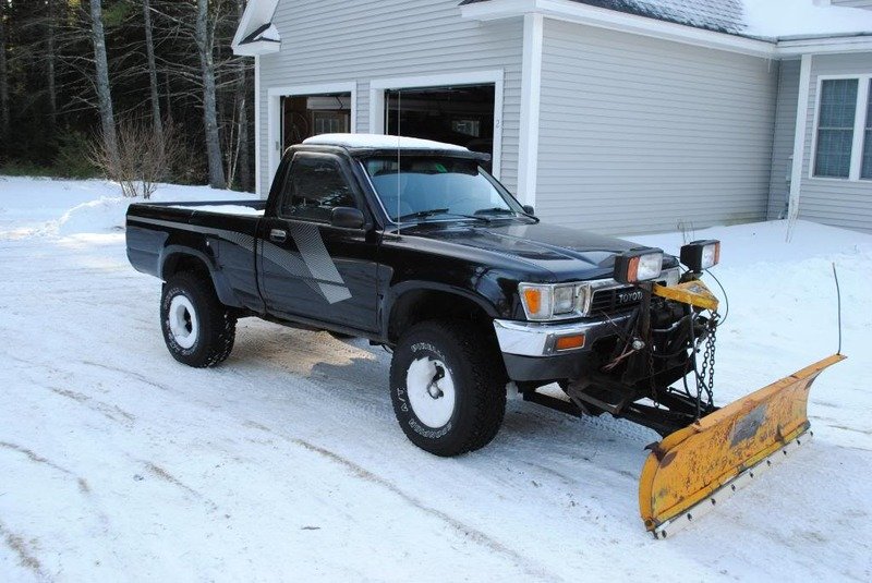

    I actually bought my first 05 when I got sick of taking the plow off my old 89 pickup to go to work. The truck was getting a bit rusty and tired anyhow so it was time for a new one. I now only use that truck around the house, it hasn't even been registered since 06. But I personally prefer to have my plow rig be a beater. I've got an old school fisher on it that's probably older than the truck. Occasionally the hydraulics freeze up but I can't complain considering both the truck and the plow setup were free back in 03. Occasionally when i'm getting the old rig ready for the next winter I think of selling it and getting something like you have for my Tacoma. Then a few months later I'll slide down my back driveway on the ice and bash into a frozen snowbank and I'm really glad it's the old beater and not my tacoma. The only problem with light duty plows like the snowbears is you can't really push snowbanks back or push a whole lot of heavy snow with them. As long as you are just doing your driveway and you plow every 6 inches or so you'll be fine. I use mine in the summer months to grade my dirt driveway.

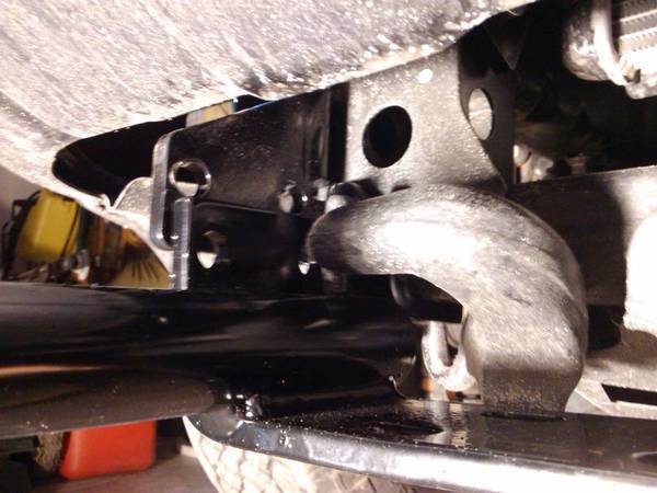

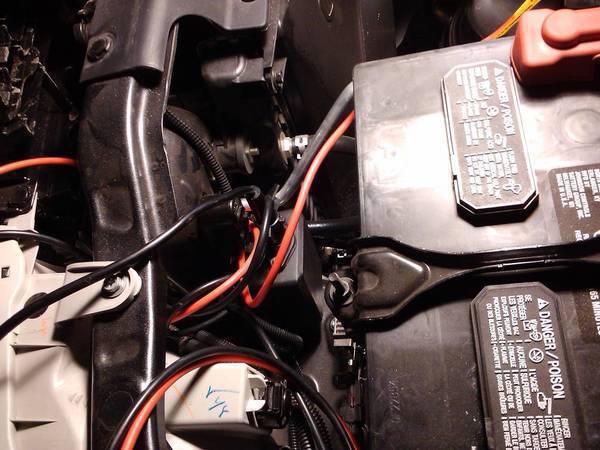

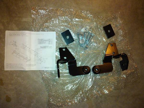

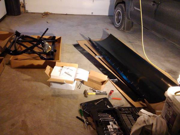

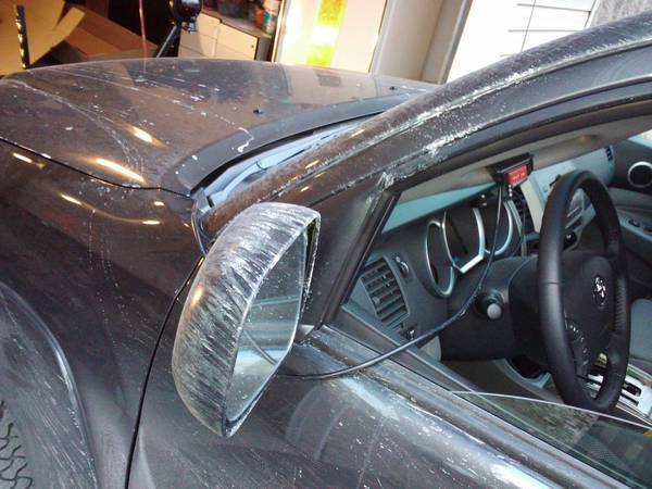

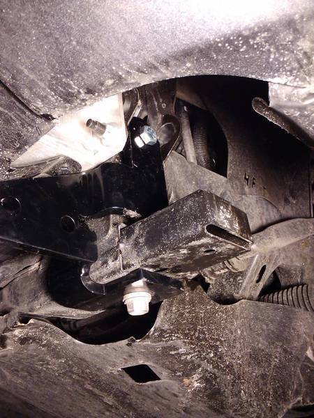

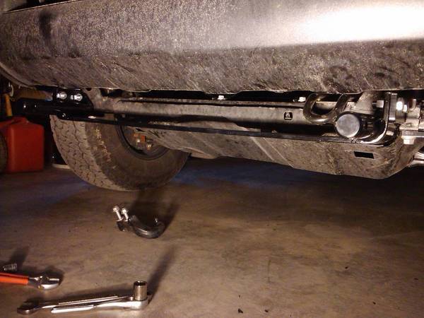

    Here is the mounting hardware:
    Mount attached:
    Cross member doen't fit with tow hook attached so I removed it:
    Attached:
    Lots of parts:
    Wiring:
    Controls (up and down), manual left and right:
    On the truck:
    Haven't used it yet but will let you know how it works.

    I don't think that would stand up to my plowing. I'll stick with my old beast. I used this to grade half my yard before laying down topsoil and planting grass. I've graded my dirt driveway with it countless times too. It plows snow pretty good too.
