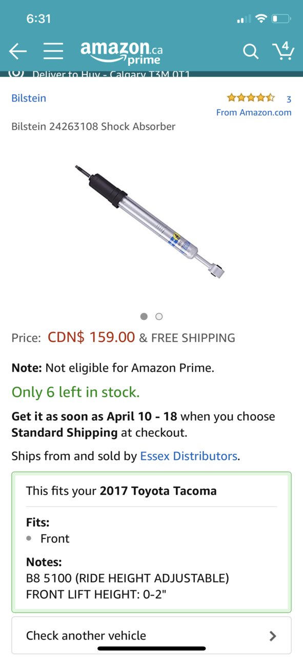

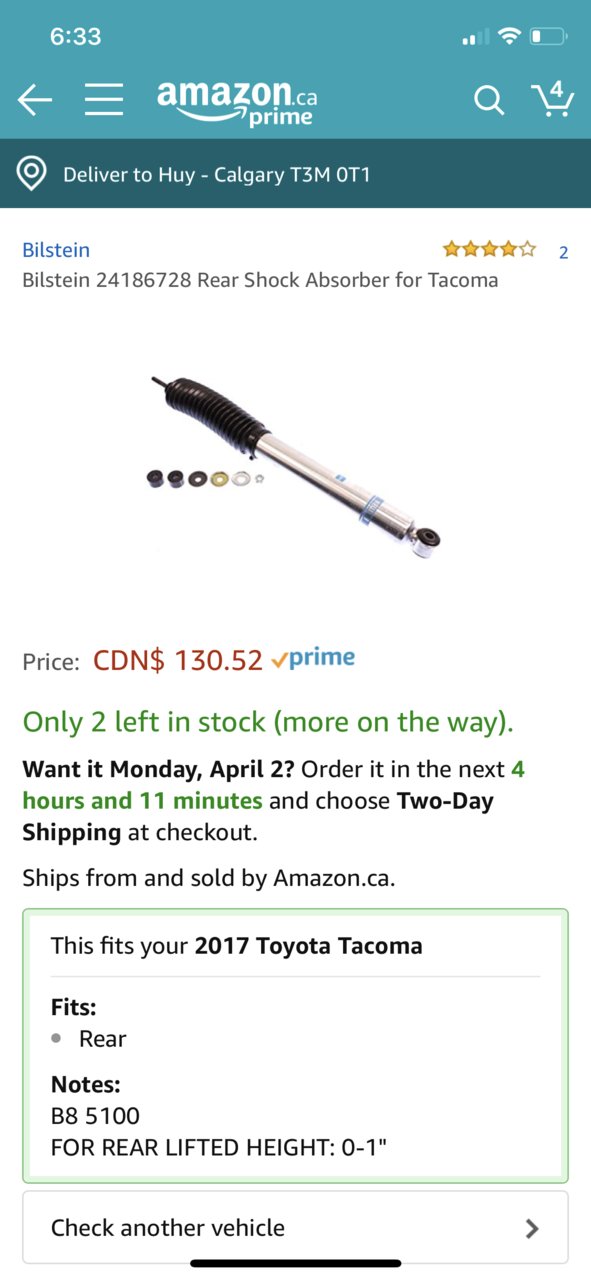

    What's the model number on the front shocks?
  12. Mar 29, 2018 at 5:35 AM
    #72
    cruxx
    cruxx Well-Known Member
    Apr 20, 2017
    #216831
    1,199
    Huy
    2017 TRD Sport
    5C38F0F2-EAD9-4A36-8A3F-84FD1C6F9AB3.jpg 3A935A5C-2B93-4BAF-8B41-1C549E340E6C.jpg
