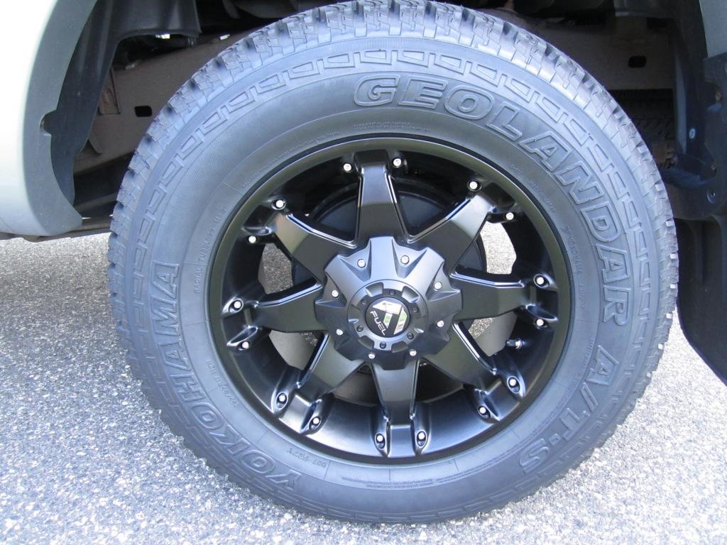

    UPDATE! Wheels are on!
    Went with the Fuel Off Road Octane in Matte black
    17x8.5, +14 offset, 5.25" back space with a 106.4 bore to be hub centric

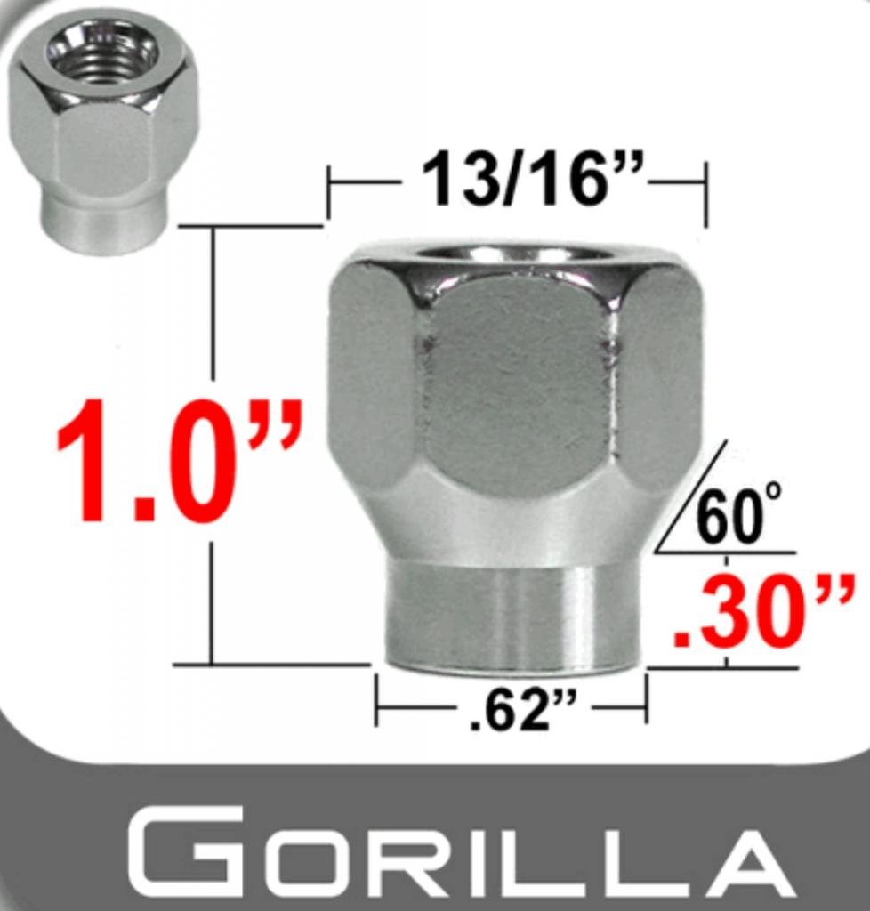

    Used the ET Gorilla lug nuts with .30" short shank to also be lug centric
    Also went with the Gorilla wheel locks with the same size shank
    This is my second set of Fuel wheels. They are tuff as nails!
    Wrapped them in Yokohama Geolander AT-S 265/65/17...sitting on stock suspension
    I love the stance! And their easy to clean...Thank you JK Motorsports

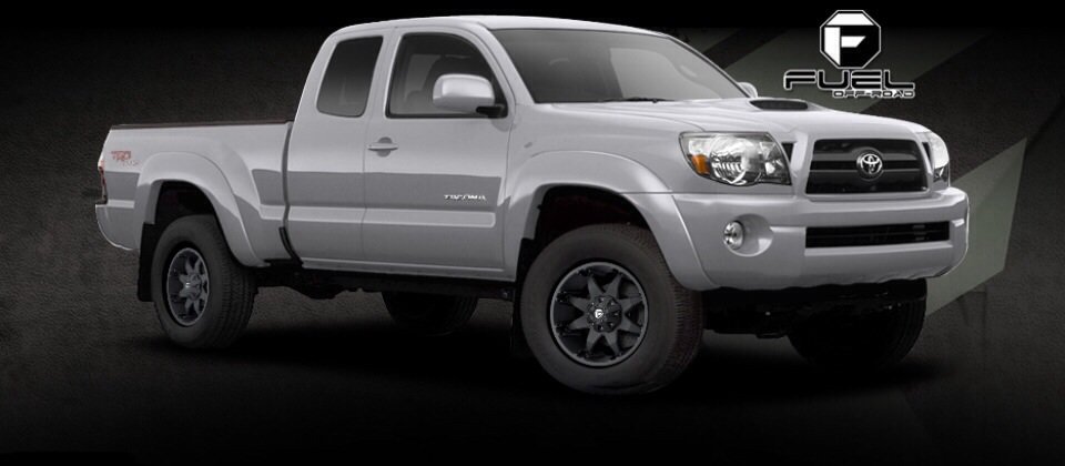

    Theo my wheels should be here Friday of next week from JK Motorsports in California
    So I will be posting pics asap after they arrive Friday
    The photo above is one I found online
    From what Ive seen online, I haven't even seen them on a Tacoma
    Ive seen them on a 4-Runner,so Let me find that pic for you

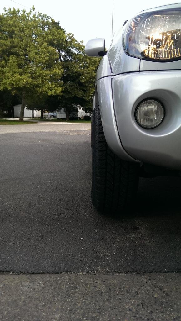

    Large,
    I wont be running a lift...the specs I chose are for stock suspension
    It gives the the truck a slightly wider stance then stock. The poke will be 1.25" further out then stock
    Here is a photo of my current set up,18x9 fuel hostage with stock suspension
    Gonna put them up for sale

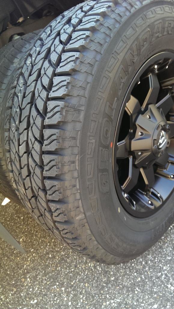

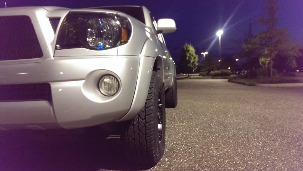

    Just showed up this morning Theo
    I only mounted one to check fitment and see how they looked on the truck
    Some stick on weights fell off on shipment,so getting a road force balance done saturday morning
    Their gonna look killer man!
    The Geolanders are plenty aggressive also
    265/65/17 on Fuel offroad octane wheels
    17x8.5 +14 offset 5.25" back space 32lbs.
    And best of all,easier to clean then the fuel hostage wheels I currently have.
    My hand fits rite inside the spokes
