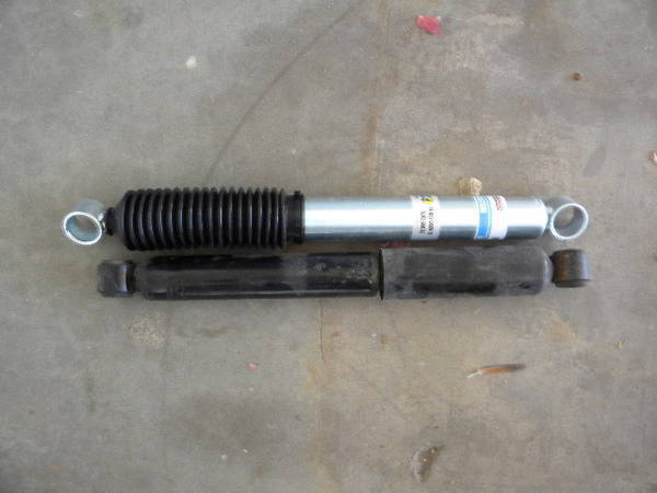

    Alright, so my shocks and springs came in. I started with the rear since its the easiest. when i took off the old shocks and compared them to the new ones i noticed the new ones are a couple inches longer. I thought i had ordered the 5125's since those are meant for no rear lift, but that means they should be same length as my stockers, right??
    heres a pic

    No, since the 5125's are meant for lift, they should be longer than stock.

    PM Sent. Those are 5100 rears, meant for use with up to 2" of lift. But we have found them to be a little too long for use on a non-lifted rear, and that's when we tried 5125s on Sonny's truck which worked perfectly.

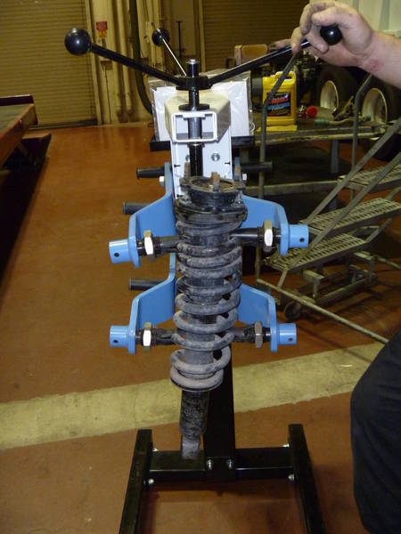

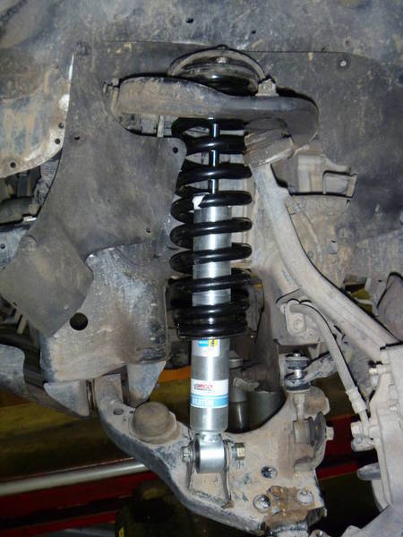

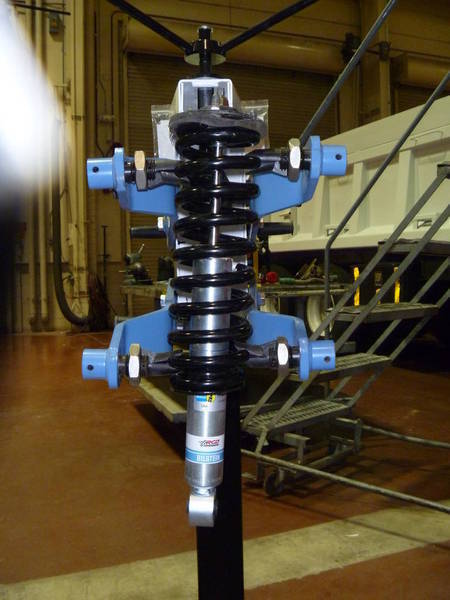

    finally installed everything! check it out, we got to use our shops new strutamer spring compressor. worked like a charm

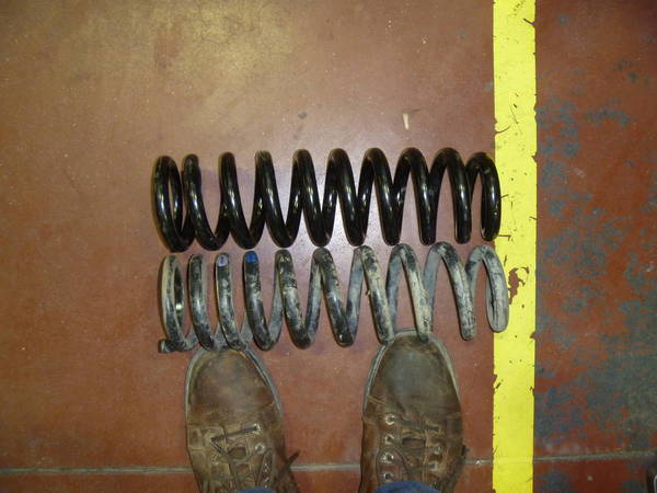

    old springs vs new
    my truck drives much smoother and handles way better. it sits at about the same height as it did with the spacers.
