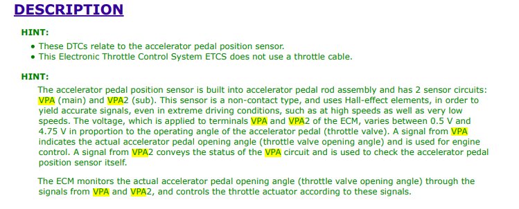

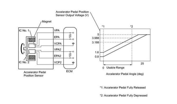

    The only output from PC is a voltage on sensor 1 and sensor 2 wires to ECU
    Tacoma accel position sensors voltage:
    Sensor 1 Released position 0.5 to 1.1 v
    Depressed position 2.6 to 4.5
    Sensor 2 Released 1.2-2.0 v
    Depressed 3.4- 4.75 v
    What PC does is amplifying the Voltage for both sensors to ECU.
    For example, 14% of accel is 1.152 volts on S1 and 1.933 on S2. PC bumps the voltage by whatever % for its driving modes, resulting in a higher requested/commanded votage to throttle.
    CAN network diagram for accelerator position sensor. There are 6 wires (3 per sensor) . Output, ground and ECU supplied voltage

    I don't think he's arguing "it doesn't do anything".
    He showing in very simple terms (straight out of the service manual) that all the PC or any such device CAN do is alter an analog voltage coming out of the accelerator pedal position sensor before it reaches the ECM.
    For a given gas pedal angle, output of the accelerator position sensor is going to be in the stated DC voltage range. The PC is going to take that DC voltage and alter it.
    It's not really magic at all.
    Yeah, it "works". It's literally tricking the ECM by giving it inputs that you as the driver are not actually doing.

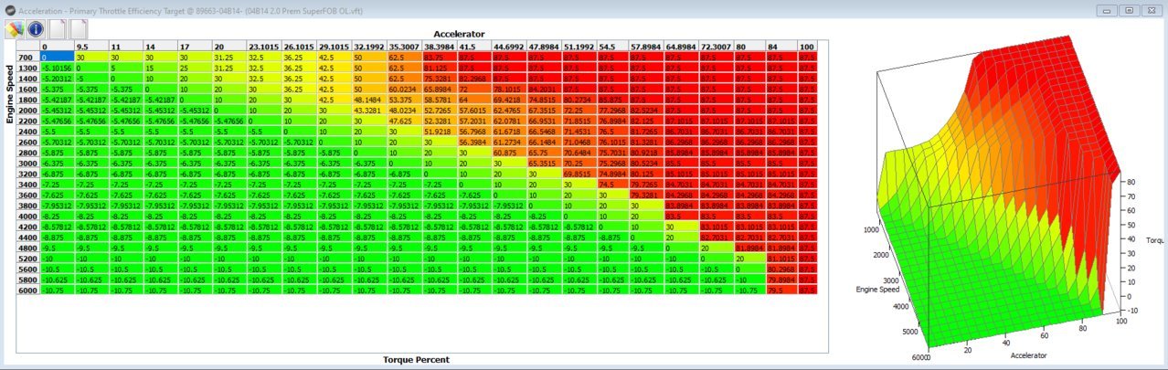

    Edit: You're still limited by the ECMs determination of "the appropriate throttle angle" for a given mashing of the gas. Check these maps out:
    There are more, including a different torque map for every gear (in the M/T), including reverse!
