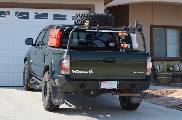

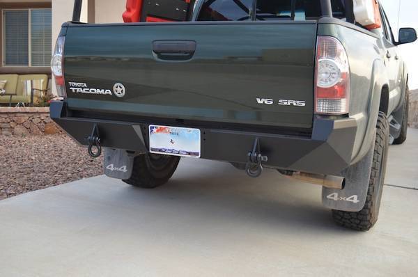

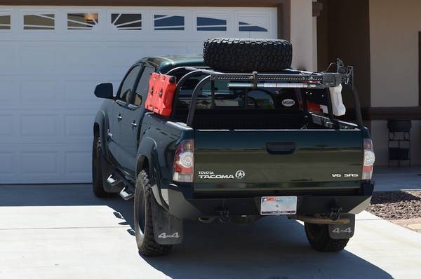

    I just installed mine by myself. Weight-wise, it seems about the same as the OEM and only took a few hours.
    I also ordered the hidden class III hitch, but haven't installed that yet.
    That may not seem too useful, but if you drop the rear off a steep shelf, the hitch is protected from damage, which it would probably endure with the OEM setup.
    Edited to add adjusted bumper with license plate lights:

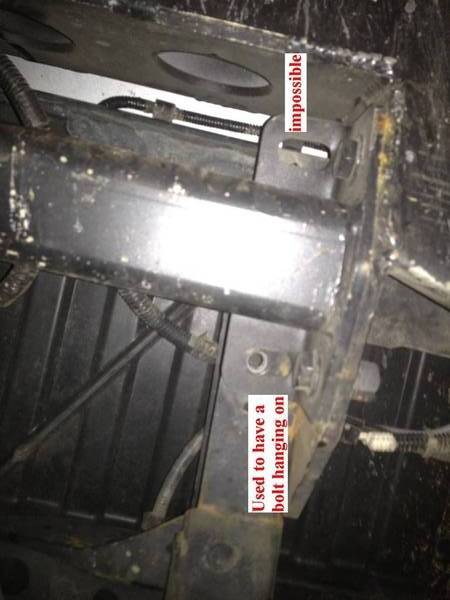

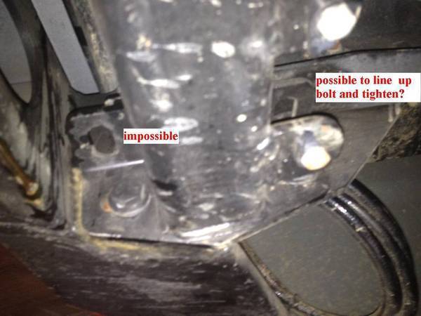

    I'm not sure if there's an install guide from AP (there isn't one on their website). But keep all bolts loose and make sure you get all bolts to get some thread, then tighten everything down. This is especially true if you have the hitch also.
    Also, the hitch has 4 bolts that go into the frame, 2 on each side. I learned from calling AP that on 2 of them, the OEM bolts wont work because it's too small. I ended up drilling and using my own bolt and nut per side
    here's the view from the bottom. the one labeled impossible is the one where I had to drill my own hole into the frame. Do this on both sides
    here's another view
    Also, make sure you take out the black plastic pieces underneath the taillights so that you can push the bumper all the way in (got this info when I called AP)
