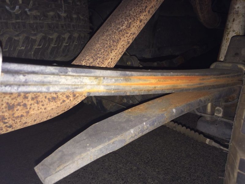

    What the hell !!?? Dude enough talk put up a pic so we can see what ya got...;)

    Here's some pics

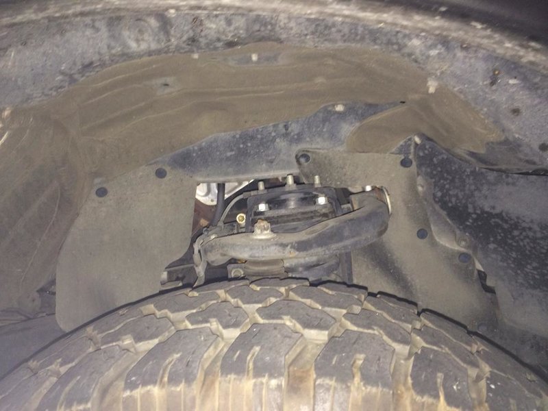

    Another one

    Ok, you've got a very tired single AAL & a 400lb slab of steel Toyota calls a overload, those things crack me up, they over compensated for weak weinie stock leafs

    That just doesn't look right...

    lol, so should putting on all 5100s and the fronts at middle maybe high be good for a couple of months. till i can get me a dakar or OME

    agree 1 AAL between the overload and stock leafs. we used to turn those suckers into knifes lol. since you do have an AAL you'll be fine with the billys in the back.
