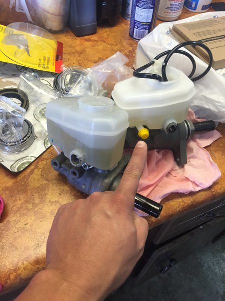

    As you can see there is a spout or a drain included on the replacement one. On the OEM version this drain is not present. I took the yellow cap off that you see in the picture and took the inside of a bic pen and pushed it back through thinking maybe this is some kind of universal fit and they simply did not bore out the hole. The pen did not push through and when I looked through I could not see a hole and because of the shape of the master cylinder I could not see if there was any band or hole in the plastic all I knew is that the big pan did not push into the master cylinder so I assumed while this boat was present the whole was not actually Milled in the side of the Master cylinder reservoir. I uninstalled the OEM one and began the bench bleeding process of the new one. That is when I discovered that all of the fluid I had put in was draining out the drain tube which must have a hole in it even though my bic pen didn't fit through it so it must be smaller than the inside of a bic pen.
    so now I have my failed OEM master cylinder on the bench and the master cylinder that is very close to being a 2006 master cylinder but not quite. I thought about trying some plugging message for this but I never forgive myself if my wife was driving the truck and something happened to the plug that I jimmy rigged in.
    so I will clean up the fluid which is all over my floor and I will wait and see what the seller does. I do know from the eBay add that they do not include a photograph of the side of the master cylinder if they had, I would've been able to tell that there was this extra drain spout and I would've been able to ask a question about it.

    Thank You, DDing. I appreciate the information. I would have preferred them to specify as such on their ad so I could have found the applicable one for my truck. THey do not seem to differentiate, and do not include a cap to cap it off. So, as far as I see it, they need to send me the right one or, send me a factory approved capping system.
    In the event that they fail to do so, which i what my guess will be, how would you go about capping this?

    Also, as far as swapping reservoirs, i would be happy to attempt this, but are there not some sort of seal between the base of the res and the mc housing? Are these basic orings?

    Thanks for the information. I am in a hurry! I just do not like the idea of having jimmy rigging in my brake system. i understand that the brake fluid resistant hose is probably easily found, and that a correspond brake fluid resistant plug is also probably sourceable locally, but now i have to spend another 2 hours on this when i thought i had purchased what i needed for my truck. nowhere did they specify between automatic or manual transmission. one would think they would at lease provide a toyota approved capping system.
    thank you for the info DDing. much appreciated. Worst case i can make this work!

    OK, what about pressure ratings? like are we talking big pressure here?

    Several marquees I've had in the past a new master did not come with any reservoir, just the cast cylinder. You needed to swap over your original one. It wasn't a big deal. The reservoir is not pressurized, it's just a holding tank.
    As doording suggests, I'd certainly be looking into that swap to get you back on the road faster.

    Ok I did it. used a small punch compined with old drill bits, swapped the reservoirs. re installed a bench bled mc. now i need to do each wheel.
    thanks all. i will teport back to tell you if the mc works well, and, if the tank seap works out without any leaking. its just a pressfit into two orings.

    appears that the reservoir swap trick worked. thank you Clearwater Bill and DDing! bled the lines, i can activate the abs now on dry pavement. good stuff. i think im going to get a reverse bleeder. seems like alot of fluid is wasted trying to draw down bubbles that want to go up instead of down.
