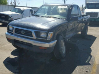

    I just bought a 97 Tacoma, 2.7, manual, 4x4, extended cab. It was smashed on the side. I already have fender and door for it. I need to replace the whole suspension system on the drivers side. I'm going to go ahead and replace the passenger side too.
    Any advice on anything I should replace/watch out for?

    Frames bend on these real easy, so I'd have it verified as straight before throwing money at it. Also look out for destroyed body mounts.

    Gotcha. Judging it with my eyes it looked good but I'll get another opinion

    X2 on getting the frame checked if theres broken suspension parts whatever the were bolted to were likely bent also check tie rod ends and the swaybar/ links

    Also left apron is probably bent and i couldnt tell you about how the door frame is
