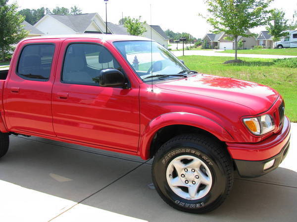

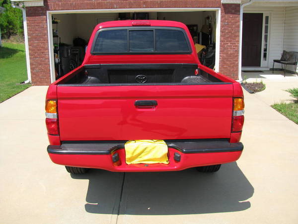

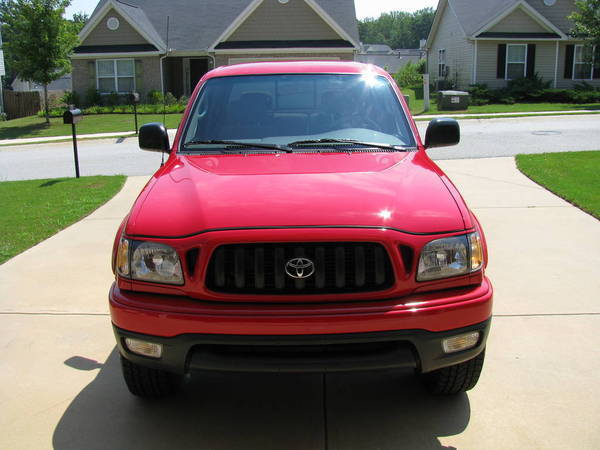

    Thought I would share my results.
    Here's what I used:
    1) LCC Orange pad w/ M105
    2) LCC White pad w/ M205
    3) LCC Red Pad w/ Menzerna Power Lock Sealant
    (I had planned to use Menzerna PO85 w/ a LCC Blue Pad as step 3, but after 10 hours on this project I said screw it. I thought it looked pretty good. Now that I've got a feel for it, next time I'll do a fourth step.)
    This was my first time doing this. I burned through the clear on a high spot on the passenger bed side trying to get a deep scratch out. :facepalm: Will keeping sealant on this spot protect it or does anyone have any suggestions?

    Nice job looks great!

    umm idk. you have any swirls in the paint man?all the scratches taken out and where did you get all your stuff from? got a link?

    You need to get that spot repainted and re-cleared before too long or it will start to oxidize and discolor. Oxidation will get up under the edge of the clear and spread. Red is pretty easy to do small blends on rather than re-clearing the whole bed. If it were mine, I'd re-clear the bedside though, I don't want any blends on my vehicles.

    A few minor hairline scratches/swirls remain but I am happy with the results. As for where I got my stuff... Autogeek.net and Amazon.
    I got the PC 7424xp bundle with 6 LCC 5.5" pads. I got the compounds/glazes based on where I could find the best price. Amazon has a better price on Meg Mild clay and M205.

    I woild go talk with a body shop about the clear in that one spot. Much to nice of a truck to take a chance.
