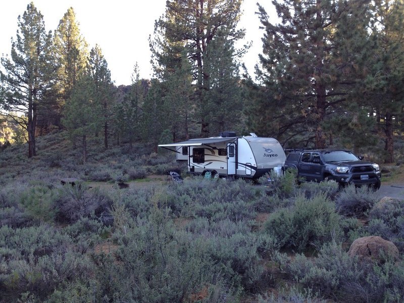

    Enjoy. Just take it easy towing and keep an eye on your transmission temperature.
    I tow a Jayco x213 (4,500lbs dry and 23ft). We're in the mountains usually towing between 3,500ft and 6,500ft on mountain roads. You know the trailer is back there but the Tacoma does just fine if your not afraid to make the truck work a little.

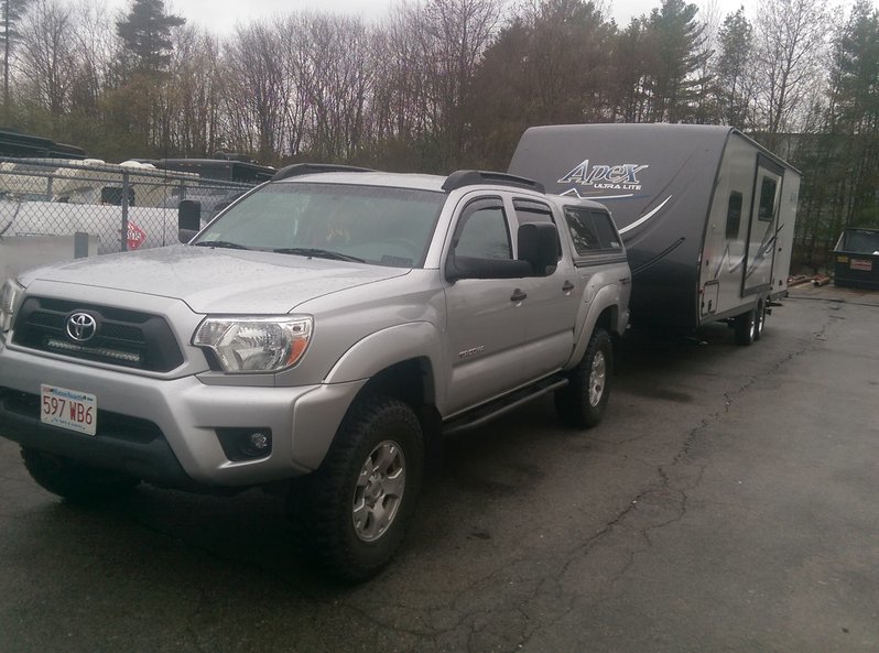

    You'll be fine, just set it up properly. Is your truck lifted? You may want some stronger rear springs or air bags. I'm lifted with old man Emu leafs and it rides great. I do short of want a tundra but I'll never get rid of the taco.
