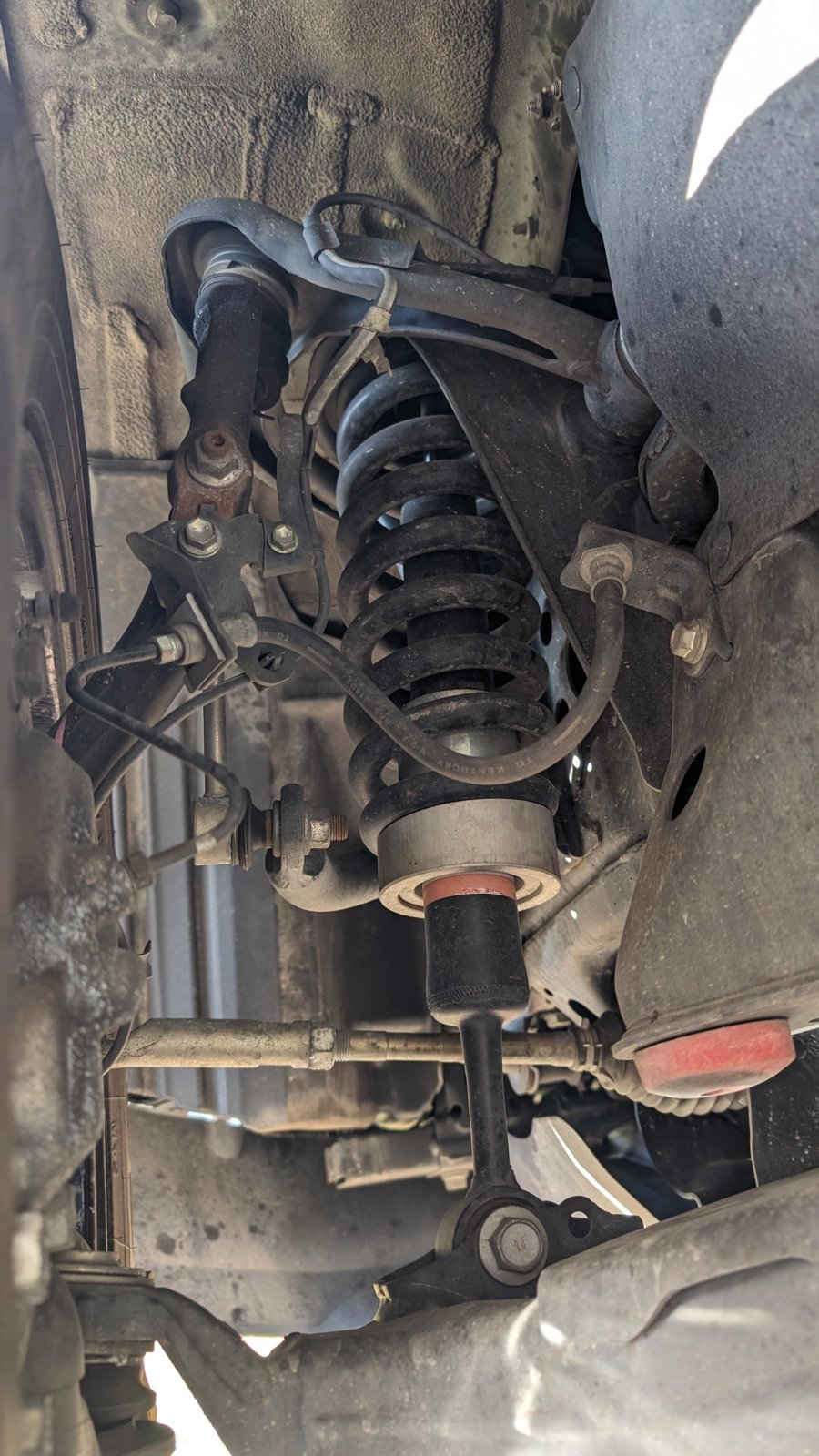

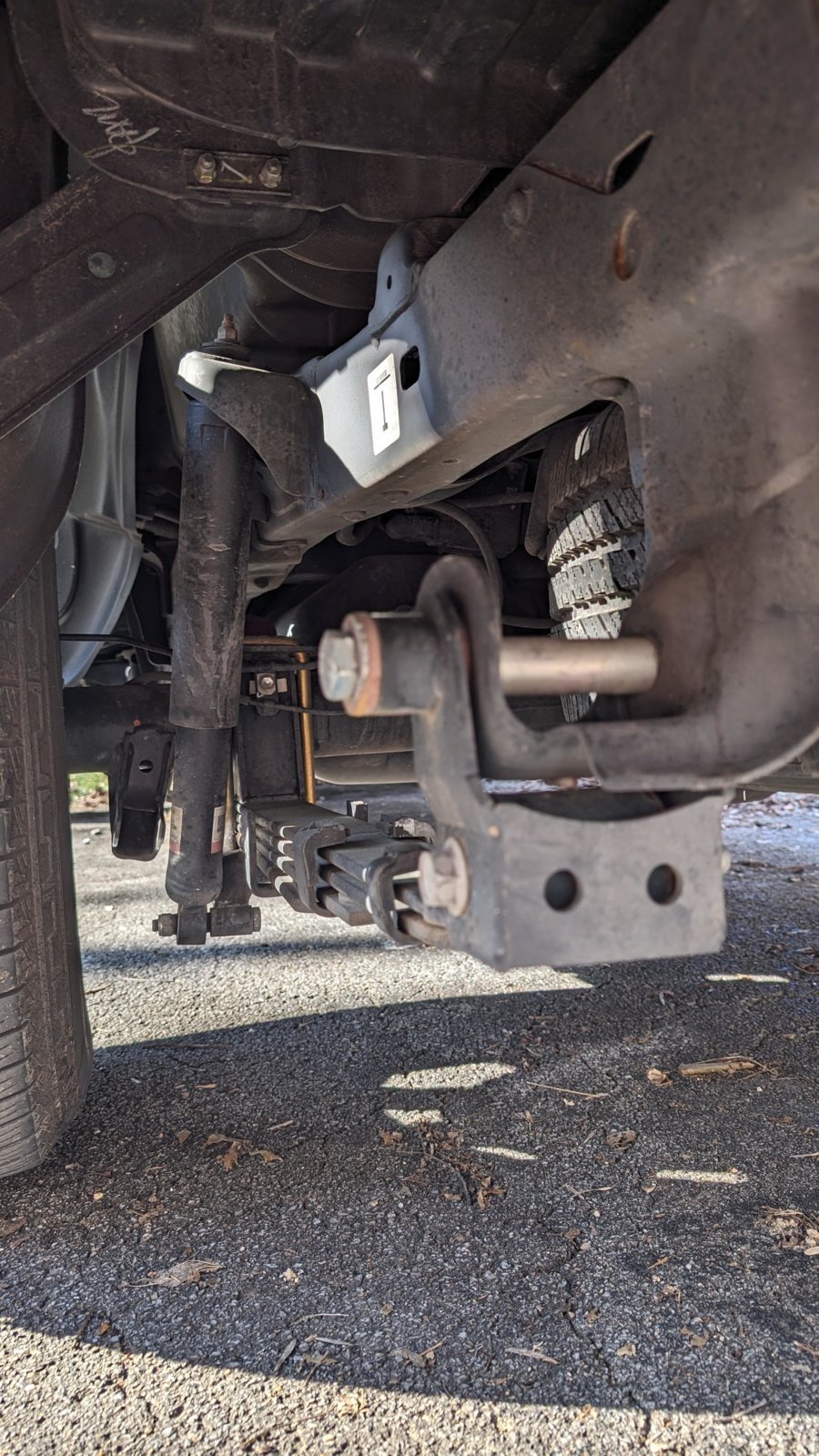

    Here's front and back suspension. Hope these are good angles. Still very appreciative of people's responses and patience.

    The front looks like they replace the shock, coil, and bump stop.
    The rear looks like they replaced the shackle, shocks, leaf pack, and lower shock mount, and bump stop. They also added longer ubolts with blocks between the axle and leaf pack.
