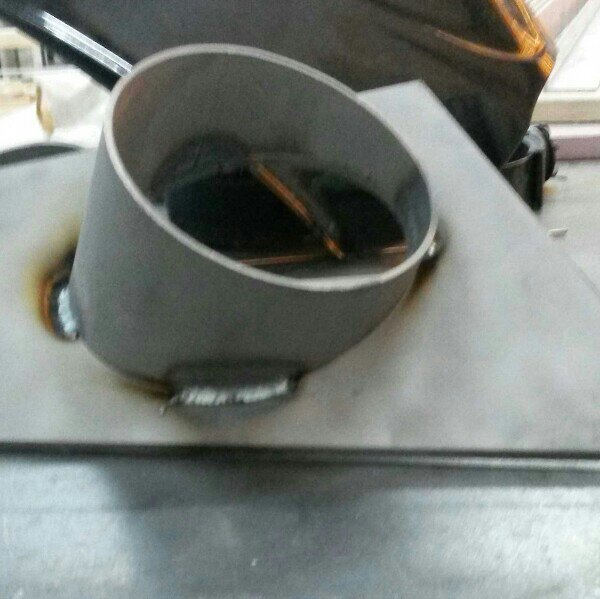

    Hey eric. When putting the fog lights together what way does the pipe go? Small side to the middle or small side to the out side? Pretty sure I did this one backwards but im not sure

    Yeah it looks backwards...
    Here's what mine looks like if it helps at all.

    Definitely backwards. You need to mirror it the opposite way. That should be the last thing you weld to the bumper aside from recovery points and top tube.

    Yeah I was holding the plate upside down when I fit it up. But I already cut it off and rewelded it. I was actually thinking to weld these and the recovery points first because it can be done on the bench without taking the bumper off the truck. Expecially the fog light holes because I dont think I could get a tig torch in there inbetween the center section and fog light tube

    Im hopping for that. My free hand skills are a big shaky, but my walking skills are pretty good right now for not having tigged in 6months. Do you weld the foglights all the way around? I only did 4 stitches. And do you bevel the edges of the plates before you weld or is it all butt welds on the back and groove welds on the face?

    Yep, 4 welds around the fog recesses.
    And 4 stitches down the insides of the long seams, and then fully weld the outside. I dont bevel any joints, just run hot to get it burnt in. :cool:
