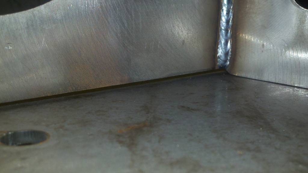

    Hey Eric. I am FINALLY able to get a bench area at the shop cleared off to get this thing started on the DIY kit for my 97. I have the top plate laid down, and the main center piece set in position. I noticed about a 1/8" gap on one side versus the other. I don't know if these pics will show well enough for you to see. Will this be a problem when I weld? I don't want one "wing" to sit higher than the other.
    This is the outside on the left (Take into account the bumper in on a bench, upside down) where there is a 1/8" gap between the perpendicular edge of the center upright, and the horizontal "top plate" The gap itself is not on the point, but where the two plates on the center piece meet up, then join with the top plate.

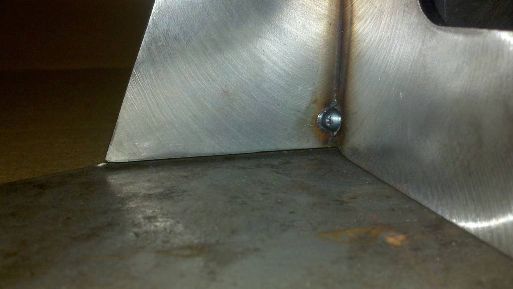

    This is the same left side, but from the back side. Same contact area though.

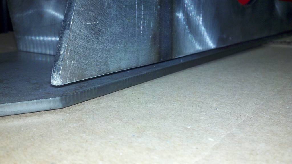

    And here is the right (passengers) side, same position. You can see it lines up almost perfect at that position. There is barely a 1/32" gap.
    It looks to me as a slight misalignment when the center unit was lined up and welded. I know I can fill it when I weld. I just want to know BEFORE I do anything, if you think this would cause any issues with one side of the bumper being higher than the other. 1/8" at the center being deflected, would that be a bigger gap at the ends? Should I grind down that part of the center support so that it will line up better, or what do you suggest? I am open for whatever. Just want your recommendation.

    Shave down the vertical plate slightly to allow the top plate to sit flat/flush. That's what we do when they come out slightly tall as yours did; I've kept the dimension of them the same as I would rather shave them slightly during assembly, than have to weld a gap if I shortened them up.
