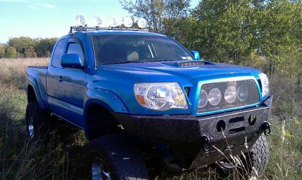

    I use the rustoleum spray on bed coating that comes in the can. Its about $8-9 a can and 3 cans gives good coverage with multiple coats, plus a little extra for touch ups when necessary. A touch up a couple times a year is probably plenty based on how mine has held up over the last 5 months. I've touched it up once- there were a few rock chips, but I also hit a rock offroad and scraped some off which is what I was really doing the touch up for.
