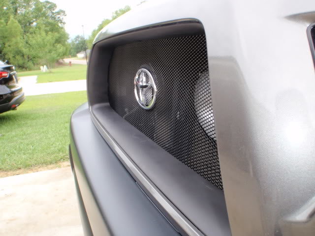

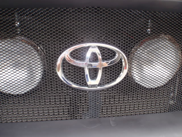

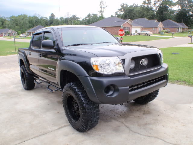

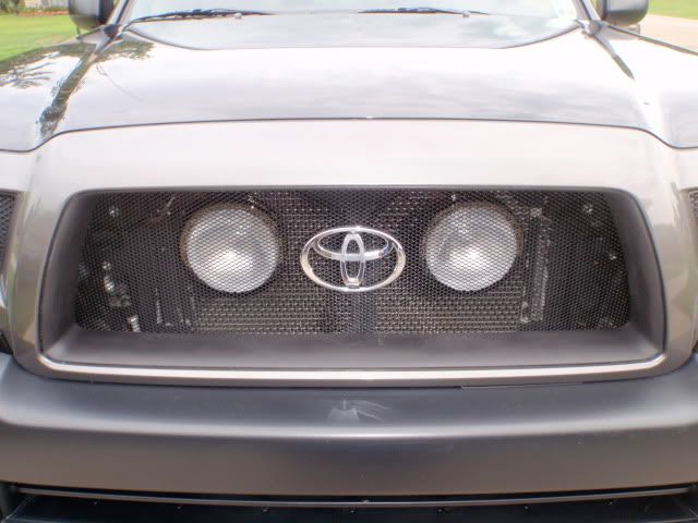

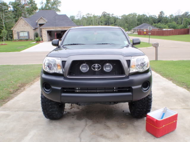

    Just took some more pics of the satoshi after spending the morning washing (ALL MORNING!)

    looks MEAN! I like it

    looks clean! Nice job!!!

    Well there are flaws trust me! I just couldn't seem to catch them in the picture.....

    Nice work!

    yes!! i mounted mine too but im still too lazy to wire them haha
    have you wired yours up yet??

    Looks good. now black out that grey'ish grill. I have a base model with that same grill. Once I painted mine it made a huge difference up front!

    I like how you kept the stock emblem, its a different twist on the Satoshi

    Yep! It was pretty easy, but a bit of advice: just go around the firewall boot instead of through it! And try to have someone hold the boot to the side while pulling the wires from the inside. I kinda stripped some coating off em because the metal was sharp around the hole in the firewall.
    I just cut the back tabs off of it and zip-tied it on there until I get my surprise from Metalmiller!
    I think I will eventually, but I wanna get my hands on some DSP first.(I really hate painting!!!)

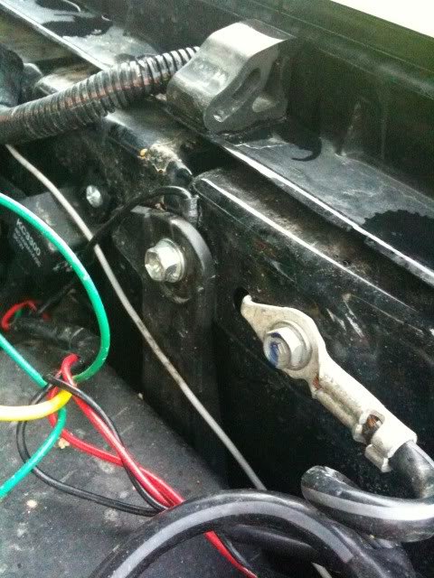

    I grounded it on the screw that holds the fuse box. It's right next to the spot that the (-) wire to the battery is grounded. Look.

    is that where you grounded everything?

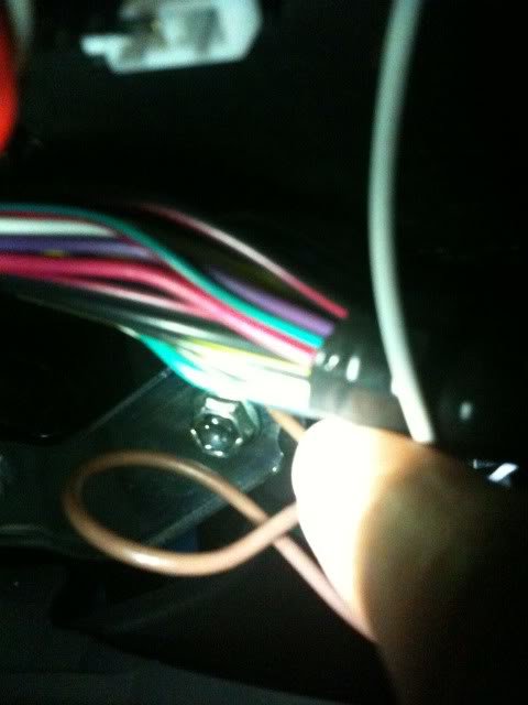

    I just grounded the lights on that screw. My camera is dead right now and it's dark outside, so a pic with my iPhone and a flashlight will have to do for now. first you have to take out your coin tray. You can see the brown wire going to the hex-nut is the ground. It was a friggin bitch doing this by the way! Not much room for a wrench!

    Finally i got it figured out!! Thanks for the help!
