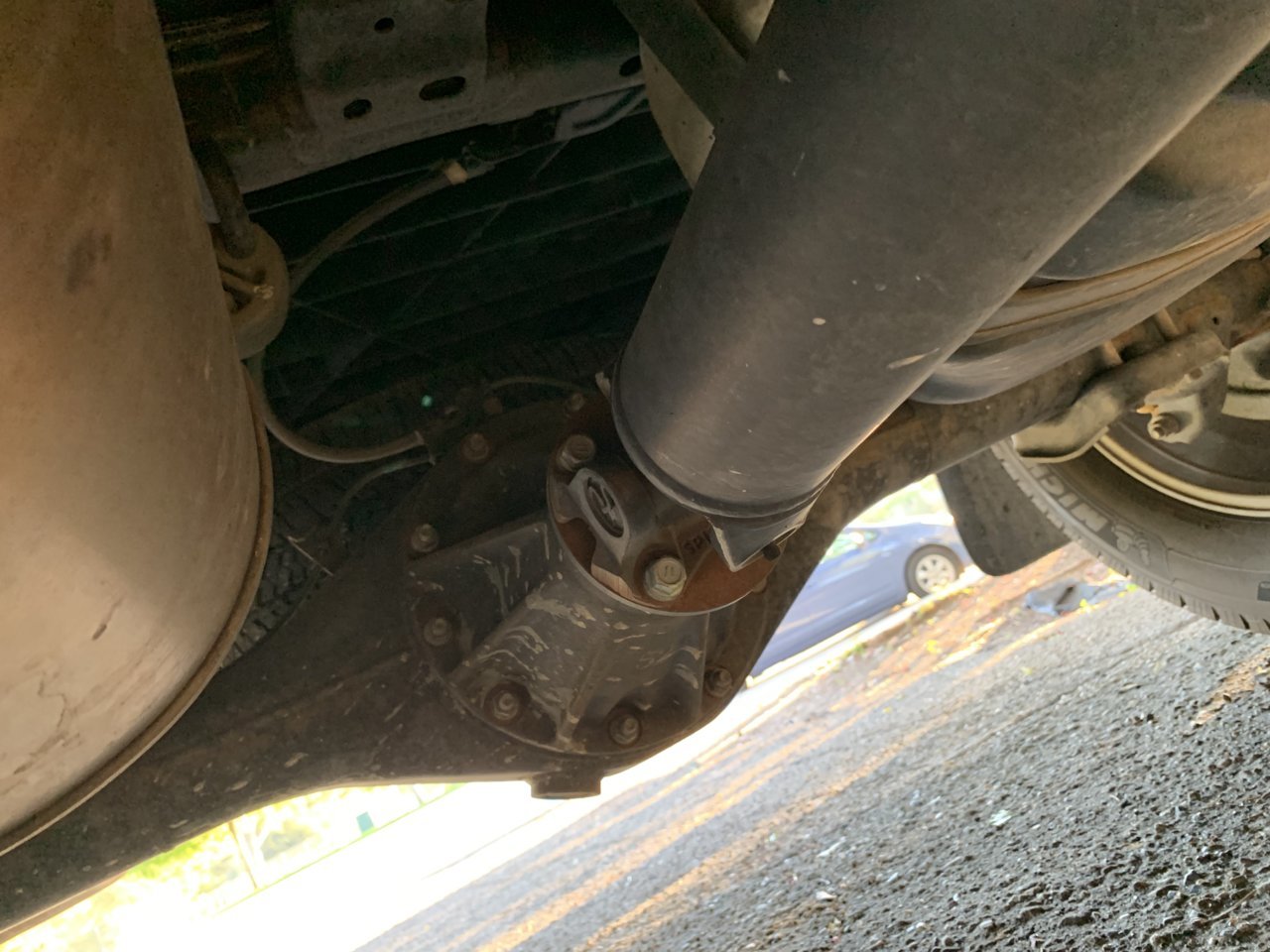

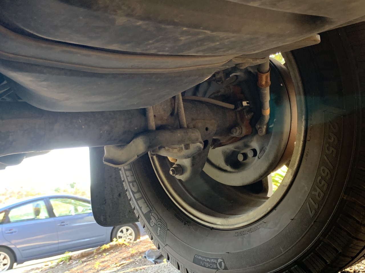

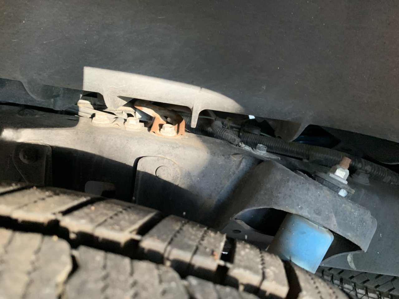

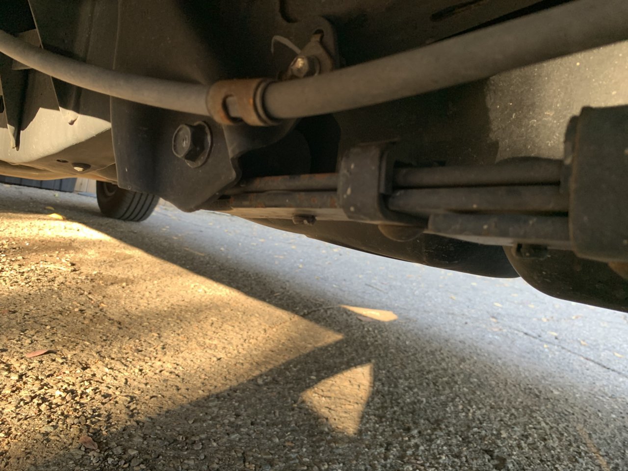

    Sorry for another frame rust thread.
    Purchased a 2015 Tacoma with only 30k on the odometer 1 year ago. Live in central California, but do surf on a weekly basis so there’s some salt exposure there I guess.
    Noticed this today (see photos). Should I be concerned? Or just unavoidable surface rust?
    I also have the Toyota certified used 7 year power train warranty. Would that cover a frame replacement if ever needed?
    Thanks in advance.
    EDIT: added a few more photos. Thanks for all the replies. I know I’m probably being way too paranoid but it helps to get some input.
    tacotoe and steelcity2 like this.

    Lol what rust? U could eat off that thing. Nice find.

    Yeah extended warranties don't cover rust. The only thing that does would be the comprehensive warranty but that's long expired for a 2015.
    As someone from Michigan I can tell you that's nothing to be concerned about. It's very clean.
    As for replacement, you may not be eligible because you aren't likely in one of the states that the recall campaign covers. You'd have to check with the dealer. If it is eligible, you'll then have to see if the service was already done. If it has your time has already begun. If not, get it done.

    Trying to find rust in these pics is like trying to find Waldo. I think you'll be fine.

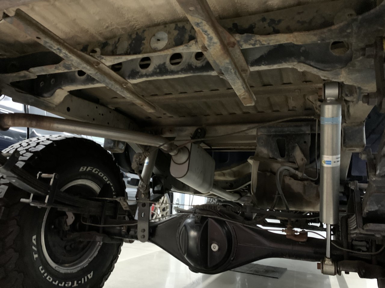

    If you aren’t careful it will look like this in 28 years.
    Underside of my 87 with almost 300k on it. Nothing to worry abt OP, the frame will probably outlive the rest of the truck.

    According to what I see, it does not apply to California. It only applies to:
    • Connecticut
    • Deleware
    • Illinois
    • Indiana
    • Kentucky
    • Massachusetts
    • Maryland
    • Mane
    • Michigan
    • Minnesota
    • New Hampshire
    • New Jersey
    • New York
    • Ohio
    • Pennsylvania
    • Rhode Island
    • Virginia
    • Vermont
    • Wisconsin
    • West Virginia
    • Washington DC
    • And obviously Canada based on the article @ABA180 posted
