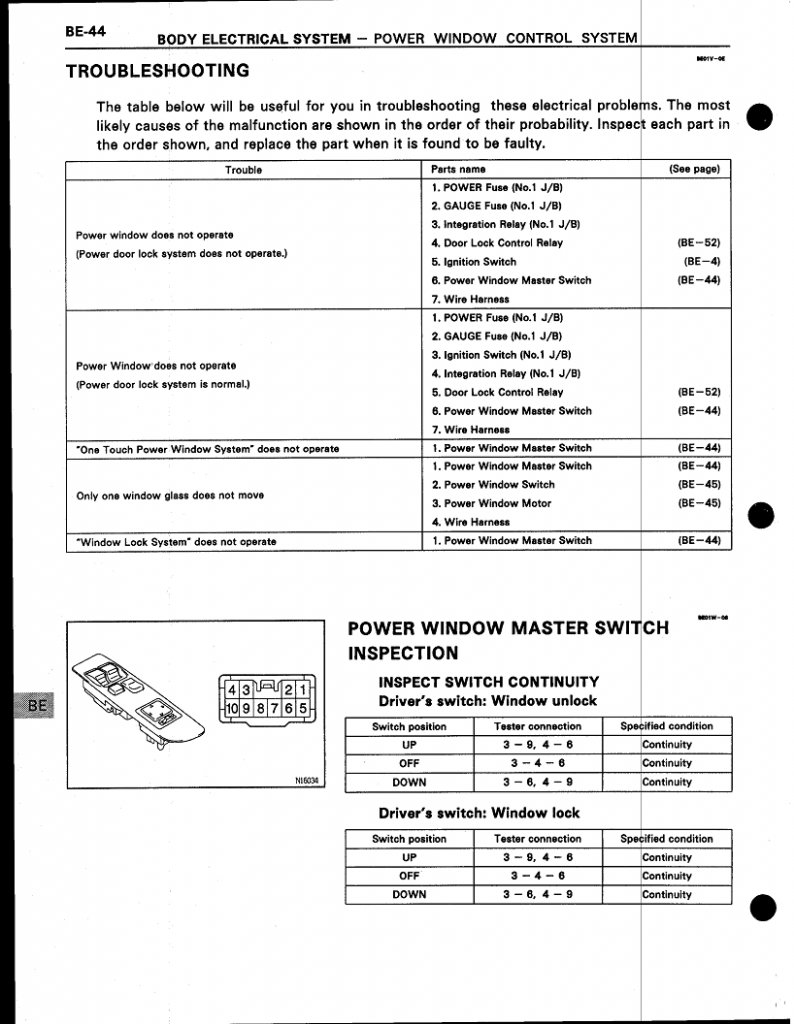

    This may not apply to your vehicle. Its probably not a lot different though.
    The integration fuse, gauge fuse, and power fuse are all in the same box under the dashboard
