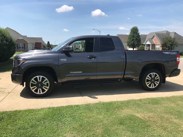

    2020 Tundra TRD Sport 4x4 / SR5 Upgrade PKG. I can't believe how nice this truck rides and drives. Very smooth, my brother has a 2018 Chevy Silverado LTZ and it does not ride as smooth a my Tundra. One thing I like about this truck is how high up i sit in it. It's like i'm sitting on top of the world, I'm a short guy at only 5'6" so this truck is awesome. I don't think i will be doing any mods to this truck other than the tow mirrors, bed cover and window visors. I like the truck just the way it is.20200731_172006.jpg
