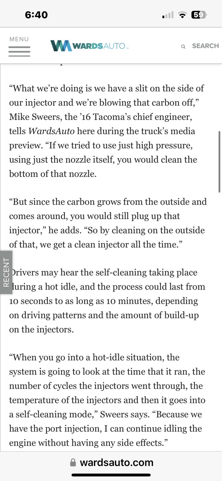

    Actually cleaning mode is when DI injectors clean themselves. They’ve got a slit at the side of injector cleaning the carbon off.
    Also port injectors clean the intake valves naturally by spraying the fuel on them.
    Mike Sweers explaining what’s happening during hot idle:
