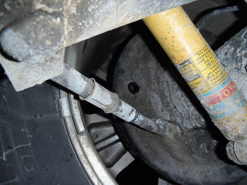

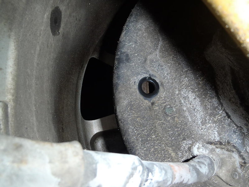

    Whelp, Time to eat some crow and man up... especially to Mike and jamie.
    There are observation holes on the back plate.... I looked twice and never noticed them... I pulled the plug for these pics.:)
    Well don't I feel like an asshole now. :eek: Anyway, thanks guys for hearing my rant and the kids at the dealerhip are ok, even though I measured a bigger shoe thickness (it is tough to see though).

    Not a prob mike. It is hard to see. I sometimes vertically rub the shoe with a pocket screwdriver to see where the material is and the shoe back begins. Just a little info for future checks.
    Your good to go..

    Glad you found them!
    But I will say, if you want to "check the brakes" properly you need to pull the drums off. Shoes wear more in the middle, which you can't see through the holes. And you can't see the face of the shoe which is critical too. Another thing is the wheel cylinder...if it's leaking you can rarely see though the hole. As well as all the linkages and the pins, if they're straight, everything together correctly etc.

    Well at least I got to look at the wheel cylinder and spray everything with brake cleaner.
    I'm still a little pissed at myself for not noticing the hole plugs. Friggin' New England weather and salted roads and salt on my undercarriage.... Yeah, I'll blame it on that, that's it :D
    Lesson learned
