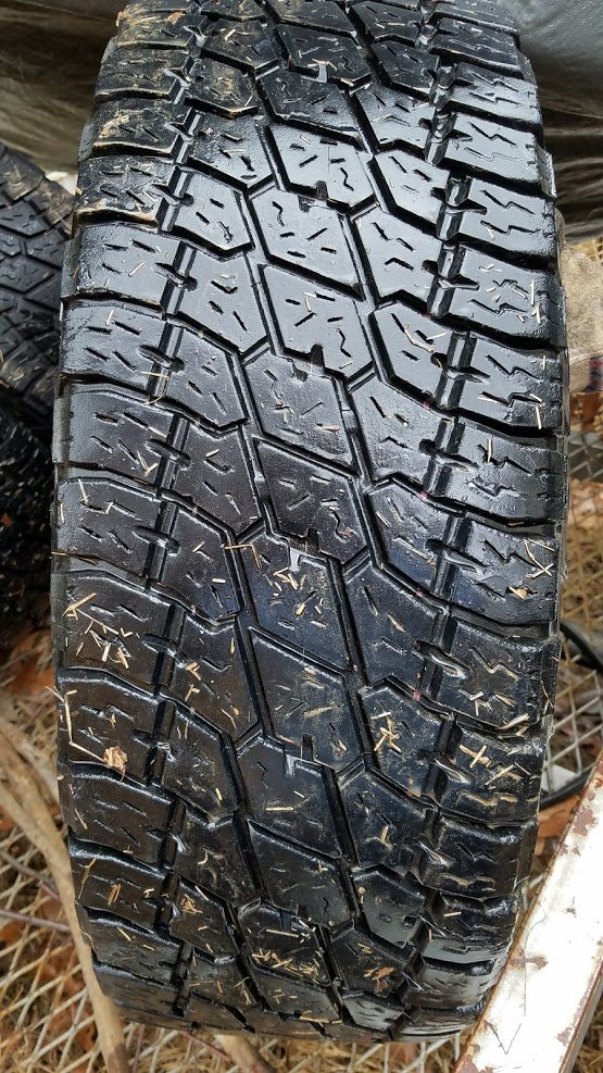

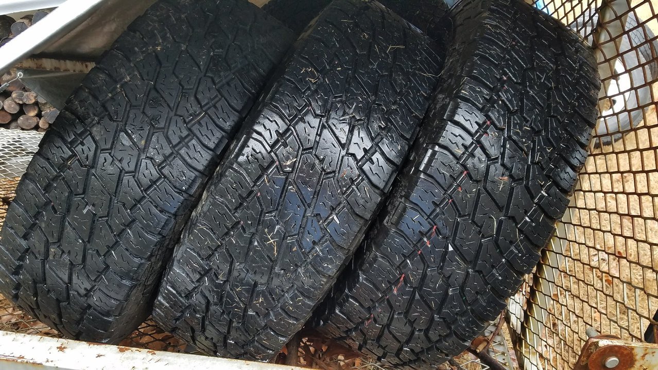

    Got 4 Nitto Terra Grapplers up for sale now. 265/75r16, asking $400 but make an offer if interested.
    2 measure to 12/32 tread, 1 at 10/32, and 1 at 14/32
