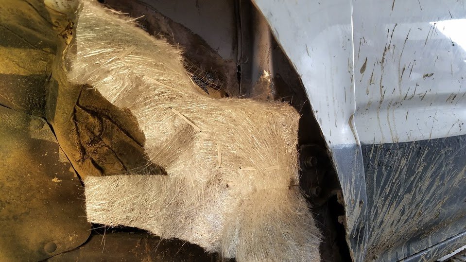

    Lol. I had to sand down the initial layer to pack some resin into the folds and gel the larger gaps. Really not picky about this looking pretty as you can tell. Not noticeable unless you're up close anyway. Plus I had no idea what I was doing this first time around, driver side should be much cleaner

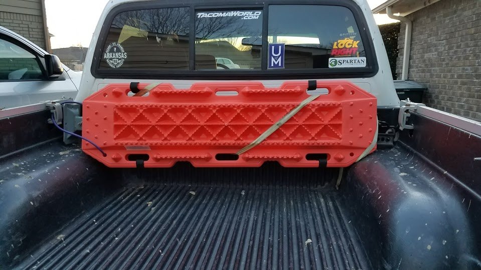

    Also, "fabbed" up a maxtrax/hi lift mount :rofl:

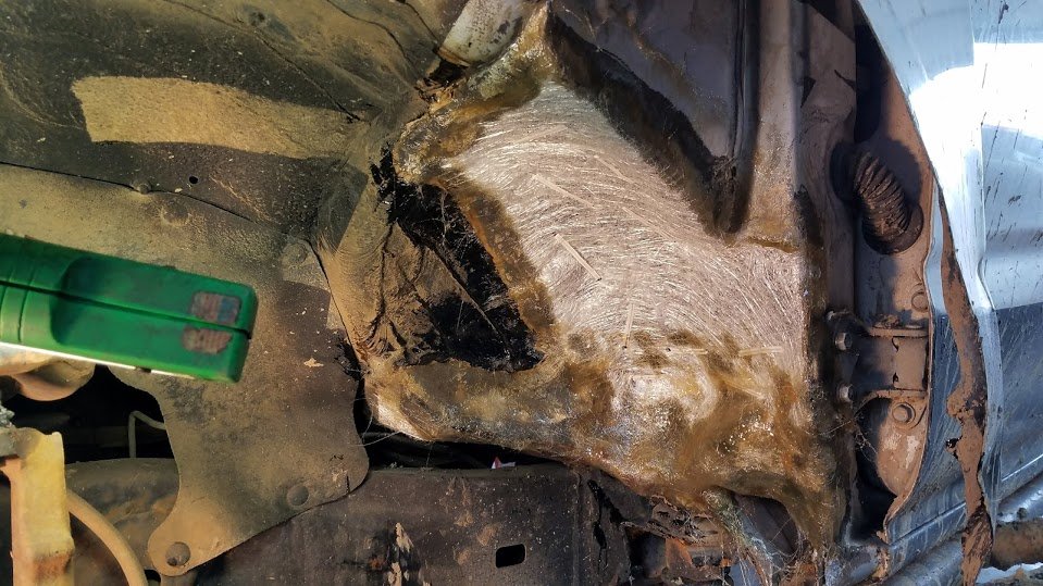

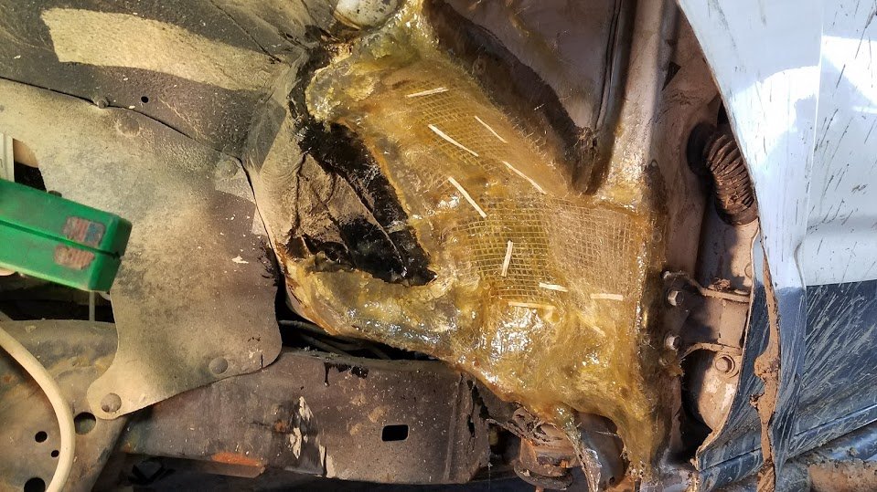

    Driver side fiberglass done. Gonna primer and undercoat it tonight
    rf-L0cjJmGsJZkF8uEKZHcd-0LyoTAwLQdYfTDK6_71d2fb512ede101393a1815331124f3037cf8380.jpg
    Here's some progress pics
    b7A878vuZSJlYLGgdxST96N9lhgmXbOb5veeXXiL_a0d19136e3c86eb9247d44cdcc5886f324c00ec1.jpg XzW781YxUvmgJA9-T_ie00HrC9r81rewZHMaKT_U_4d6ace179004ff6e11ea23ef8fb24657a729dacb.jpg

    Why did you decide to do fiberglass instead of steel? Just curious.

    Partially out of curiosity, partially because my welder is total shit and wasn't having any of the sheet metal tub haha. The fiberglass is a fun experiment though, if it works I'll keep it and if it sucks I'll borrow a better welder and do it the way everyone else does it

    At this point I'm rooting for ya, an interesting experiment for sure. How did you clean the edges where the fiberglass and resin adheres to the body? I'll have to do this soon enough, although to a slightly lesser extent what with long travel pushing everything out a bit.

    Grinded it all down to bare metal with a die grinder if thats what you're asking. Then I screwed in a metal wire mesh and "stitched" in Bondo Mat with twist ties with the paper cut off. I applied the resin to the edges on the bare metal first so I would have a frame to work with. Driver side came out way cleaner than the passenger side because I actually knew what I was doing this time haha
    Also, on the driver side i just notched out the area of the floor that was in the way and moved it back some instead of cutting it all out, letting me retain a lot of the metal there and just fill fiberglass around it. This worked out way better than the passenger side for the fiberglass method. 10/10 would recommend. Took about 5 hours for this side including paint
