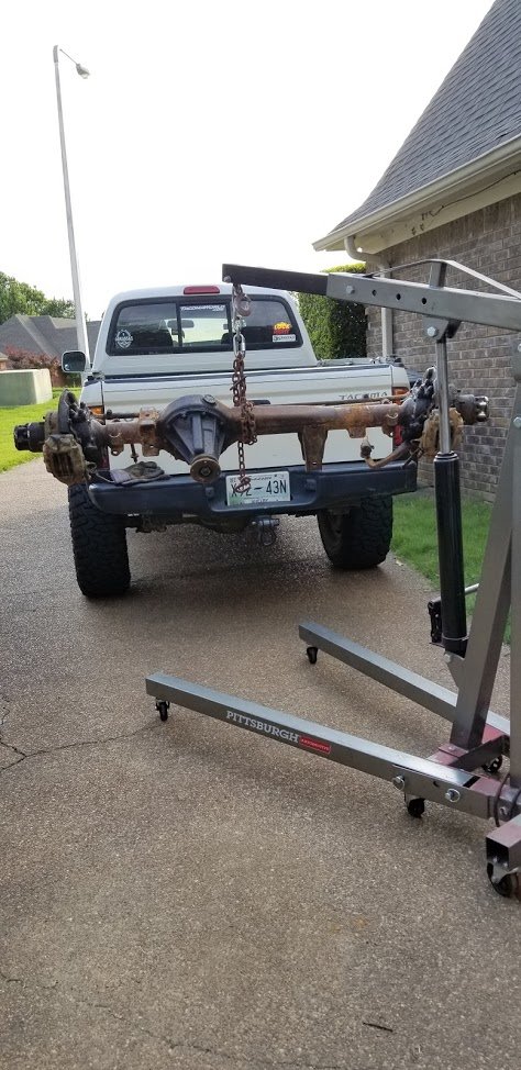

  14. Jun 5, 2018 at 2:25 PM
    #434
    Justinogo
    Justinogo [OP] Well-Known Member
    May 15, 2016
    #187022
    1,505
    Justin
    Memphis, TN, USA
    1985 4Runner
    3rz, 37s, Locked, 5.29s, 4.7 Marlin case, OG LongFields
    3kX1NGvYEtcrOCNdGe4G5vcfMOSfMBy7GTkH0IO4_c8c36b4a793e48b3f57905001c93e70d395ebdb6.jpg
    Got the axle out of the truck and into the back yard, waiting on the IFS hubs and steering box to get here. I think this thing may have a locker, but not sure, I just hope it isn't welded. With both hubs locked, when spinning one side the other side spins the same direction, and spinning the pinion makes both sides spin the same direction. Holding the pinion in place does not allow me to move either side at all. Because of this I have a suspicion that there is a locker in there, but won't know until I get time to pull the third one night this week.
    dirty deeds likes this.
