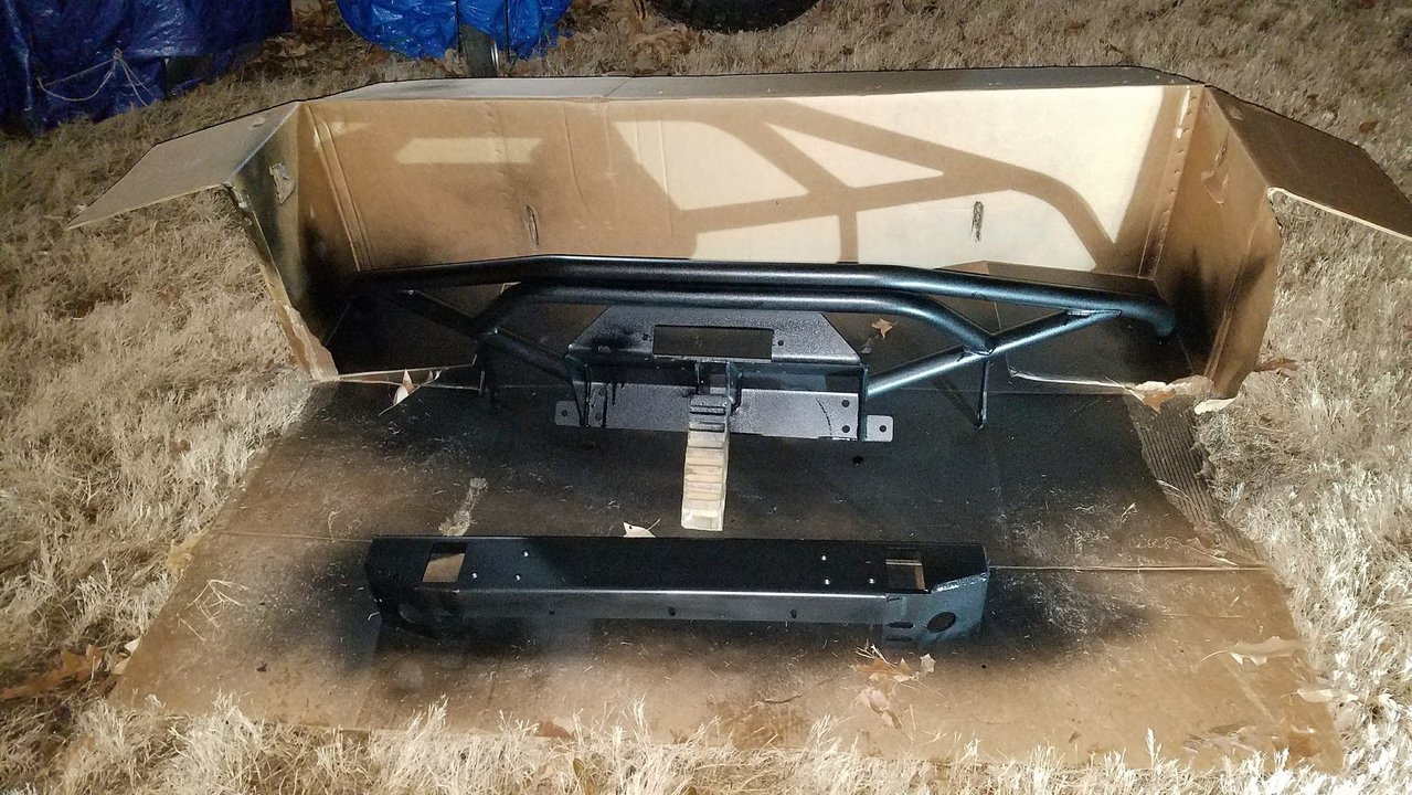

    Yes Justin, paint your bumper in the dark at 6:30pm with a shop light. Brilliant idea. We'll see if I regret this tomorrow.

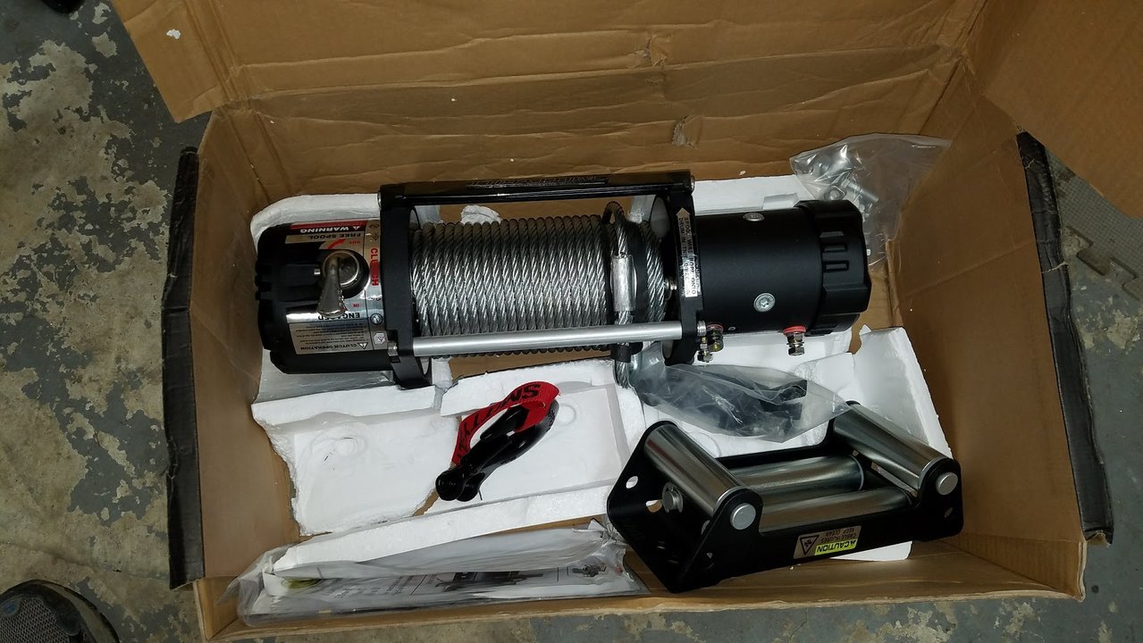

    I’d that a smitty built winch?
    ChadsPride likes this.
  12. Jan 22, 2018 at 5:00 PM
    #52
    Justinogo
    Justinogo [OP] Well-Known Member
    May 15, 2016
    #187022
    1,505
    Justin
    Memphis, TN, USA
    1985 4Runner
    3rz, 37s, Locked, 5.29s, 4.7 Marlin case, OG LongFields
    Yeah, 9500

    Just got the same one recently. Be careful with that piece the remote plugs into I barely hit it with my hand and broke all the screws out.

    Pull that winch apart and repack it with AMS oil synthetic race grease before you even use it. Ask @allmotorrex or @beertimecontinuum why....

    Ah thanks for the heads up. Not expecting top notch quality, just good enough

    ? Do they have a tendency to seize up?

    Insufficient Chinese grease inside. Pull apart the planetary gears set, clean of old grease, pack in new grease. I used Amsoil because racetruck. Will run smoother, cooler, longer..

    Huh. Do people actually have problems with these winches when they don't replace the grease?

    Not sure if trouble or if someone pulled theirs apart and saw no grease or what, but many people advised me the same. When I got it apart and saw how little grease there was I knew I could only improve it by replacing the original grease with more and better grease. I plan on using it often :D

    Haha, yeah no doubt it's an improvement. Just wondered if it was ever really an issue
