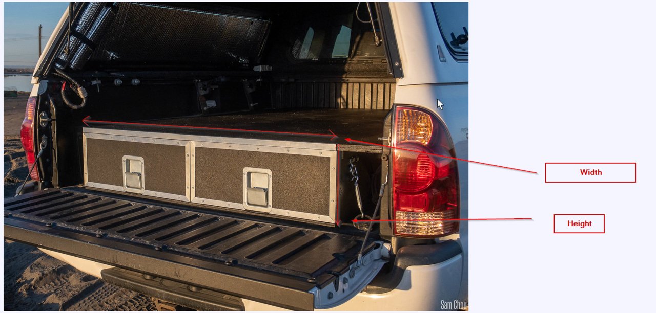

    Working on designing my setup (thinking on going with extrusion frame), what's the width and height of the drawers by chance?

    I believe he said in the YouTube video that it is 42" wide (go to the 4 minute mark). For the height, I'm starting my designs based off his and I need to confirm some measurements but I'm probably going to use something like a 9.75" overall height using 1/2" plywood. This way I can have the side flaps cover the wheel wells and sit flush with the rest of the platform. Don't take my word on that though - I still need to mock up a few things, best to take your own measurements and see what fits for your truck!
    Edit: For what it's worth I'm doing mine 42.5" wide and 9.75" height using 1/2" birch plywood.

    Finished dimensions are 73" x 42" x 9.75"
