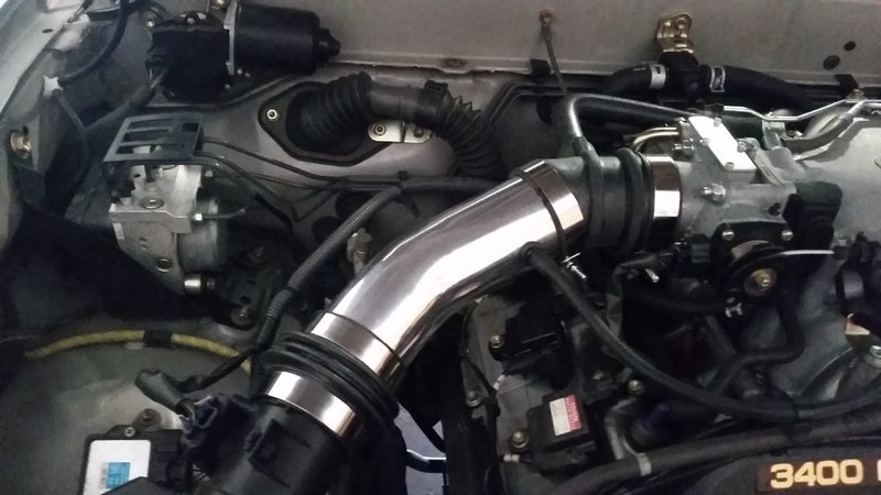

    The truck already had it installed. Honestly I would prefer the stock air box if I had one.
    I have read mixed thoughts on them so who knows. I ordered a charger kit and will just run it I guess. I don't have a stock setup for it anyway. Thoughts ??

    Very pro job there!
