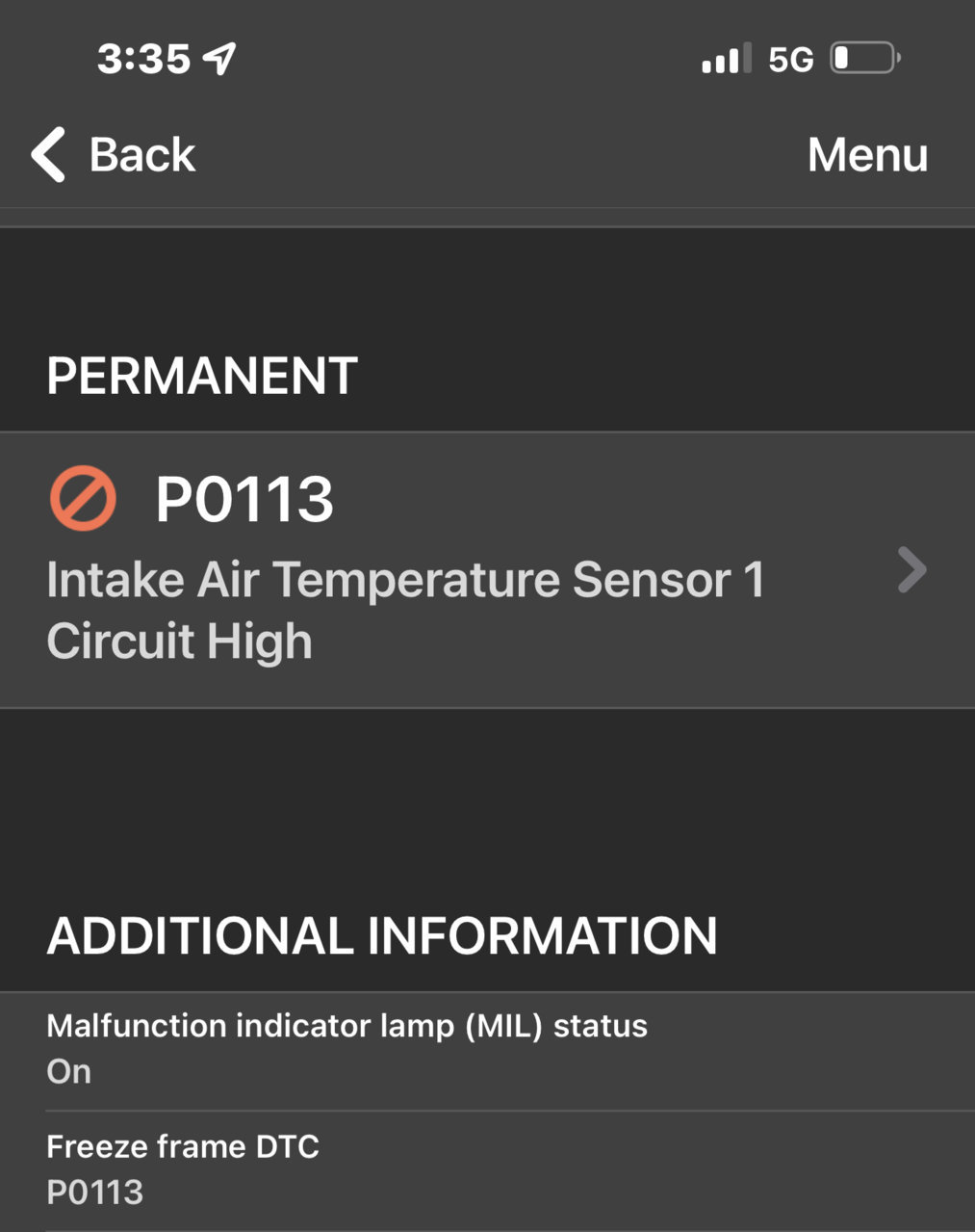

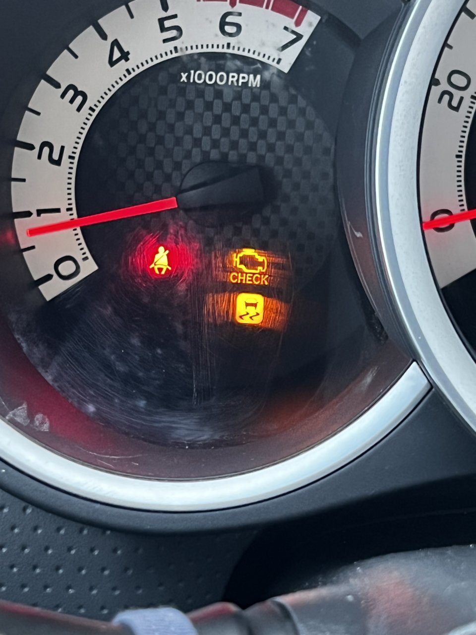

    Just installed my K&N cold air and take everything went fine everything connected and now I am getting my check engine light with a skid control light
    Truck runs fine but code P0113
    See pic, So in this instance do I have to drive like 50 miles or so till it learns again?

    The IAT sensor is integrated into the Mass Airflow sensor, I'd check and make sure you didnt pinch or break a wire going to it.
    You can look at IAT in scan data and see what it's reading, it should be reading close to the actual outside air temperature.

    I had my old mass airflow sensor installed on the cold intake so I did not use the one that originally came with the truck, could that be an issue? I would not think

    It's a possibilty, you could swap them and see if the code clears.

    Found the issue
    The MAF. Sensor was about1/4 inch long on my current one that was throwing codes
    I put the OEM one in that came with the truck cleared my codes went for a drive
    All
    Cleared so far
    The difference was the sensor in old one was about 1/8 inch long. Very short and stubby
    When I put the Toyota one in, that sensor was twice as long and worked great
