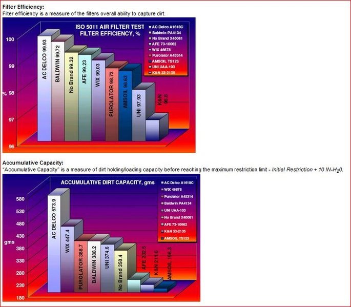

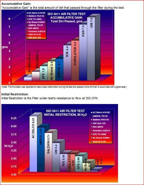

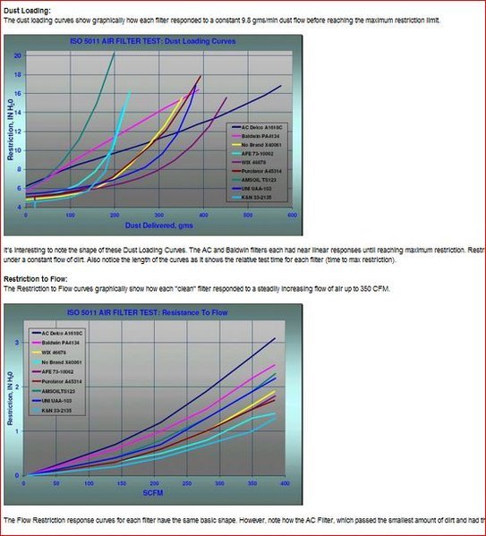

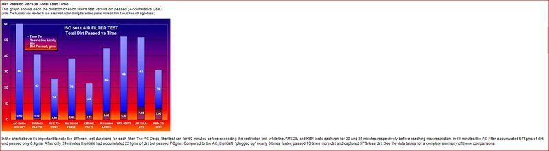

    From Dec 2011 to Jan 2017, this thread comes up when doing a search.
    As far as a part #, sorry, no help.
    Other searches brings up this multi air filter test.
    http://www.billswebspace.com/AirFilterTest.htm
    "This report presents the results of an ISO 5011 test of several air filters designed for the GM Duramax Diesel"
    See link for the details.
    aFe is not much better than the K&N and they both are on the lower end of the scale.
    I just ran a K&N in my last tank of gas on a 2017, 3.5 4D, LB, 4WD, Tow Pkg.--- Not enough difference to matter.
