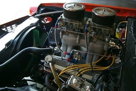

    14,750
    Chuck
    Gallatin Tennessee
    02 Pre Runner supercharged 4cyl
    TRD supercharger , Doug Thorley header , K&N CAI 265/75-16 Toyo open country mud terrain , 15x8 Method Racing wheels , Rancho 3" lift , 4.88 gears , Detroit Locker
    The Dyno operator said that the filter tops cause disruption of air flow over the air bleeds in the carburetor !!!! . Once I put the metal air cleaner lid back on I picked that 11hp back up on the next dyno pull !!!

    That's so sweet!!!:thumbsup:
    I wanted to put dual quads on my 428 powered 69 GrandPrix, but l couldn’t afford the tunnel ram and dual 390s.
    Seeing dual carbs on a tunnel ram always brings me back to those days :).
    Thanks for sharing
